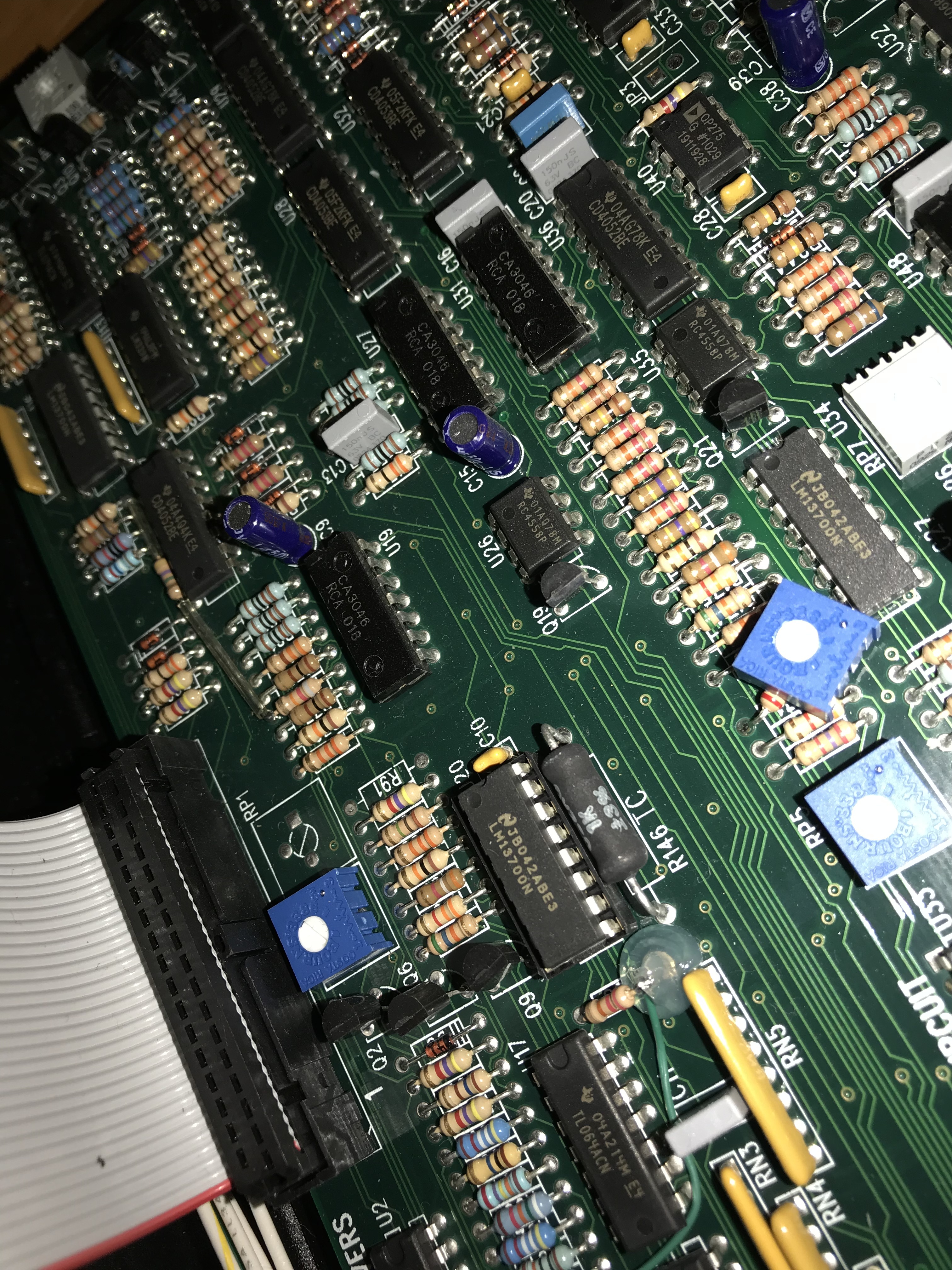

Hallo people, I have here an 8-year-old Voyager with filter glide Mod. The keytracking and Octave I have been able to set properly. But the filter spacing is off. In zero position, the right filter is 10% more open. Also you notice in the closed position slight phase shifts between the left and right filter, which is noticeable by extinctions. It is subtle, but noticeable
I would like to receive a reconciliation instruction. Oscilloscope and multimeter are available

Ok I understand. What I’m not quite clear, I ask for an adjustment and not to schematics or boards layouts. There are probably 3 trimpots and the box is running again …
In my opinion, there are forums for such things, my Voyager is not broken, he has only pretended

you are right, this is only an adjustment and only means moving trimmers. it is something you can easily do yourself
