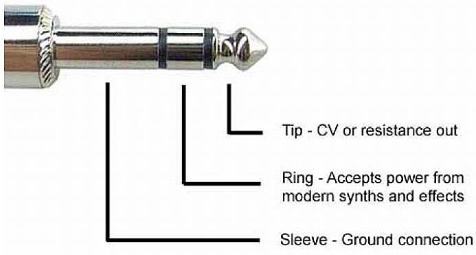

I’m thinking to use external control voltages with the Voyager. The Voyager red TRS jacks supplying +5V on the ring. Would it be possible to feed a CV into the Voyager, e.g. from an Etherwave plus Theremin, by using a “mono” connector with only Tip and Sleeve instead of a TRS type (Tip-Ring-Sleeve) without damaging the Voyager? I’m concerned to create a short circuit with a 2 pole connector.
following image stolen from the Walking Stick Operation Manual from Psionic Soundworks:
This is no problem - each input on the Voyager that takes an expression pedal input has its own Ring voltage supply that is designed so you can plug in a Tip-Sleeve plug without worrying - it basically just shuts off the ring supply on that input when you plug in a TS plug…
