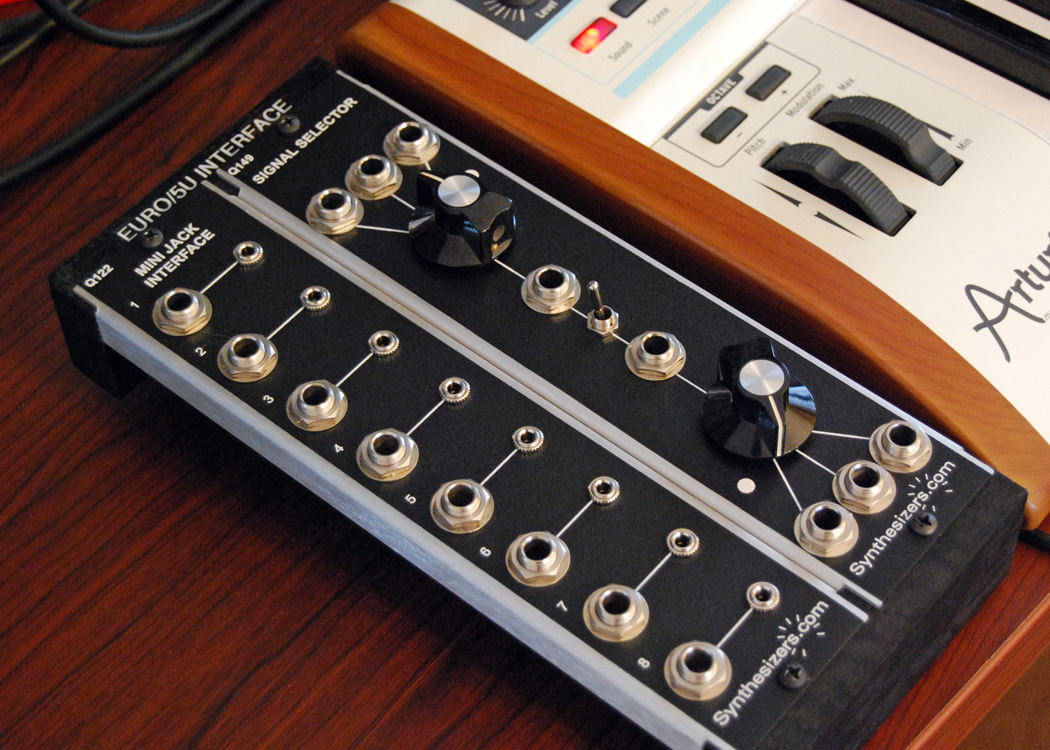

You could also build ( or buy, dotcom sells them ) 1/4" to 1/8" jack converter panels, to interface signals between the two. Might be easier than keeping track of adaptor cables?
Cool idea - thanks ummagumma. :smiley:
A few years ago I built this portable utility box from the aforementioned Dotcom jack converter panel and a signal selector panel. Comes in very handy to patch the two different connection types:
Panels are available from Synthesizers.com here:
https://shop.synthesizers.com/collections/all-modules/products/q122
https://shop.synthesizers.com/collections/all-modules/products/q149
