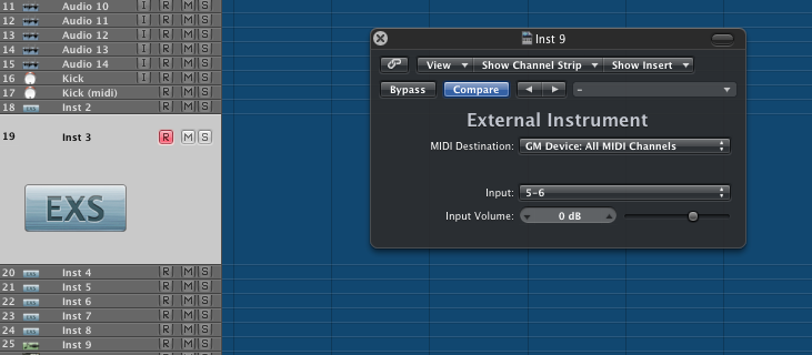

i’ve connected my Moog to inputs 5/6 on my audio interface, then in logic i’ve created an instrument track and selected ‘external instrument’.
Here’s my settings -
My problem is that when i go to another midi track in logic, it plays it BUT it also is still playing my moog sound.
I was just wondering what needs to be done so that i only hear what track is currently selected?
thank you for any help and advice,
Tom
Turn Local Off on the Voyager. The rest of the problem is probably related to the configuration of the sound card.
Sounds like you’re using the analog outs on the voyager while using Midi tracks (ext inst). You need audio tracks for the outs, and ext inst track if you are controlling the voyager with midi.
