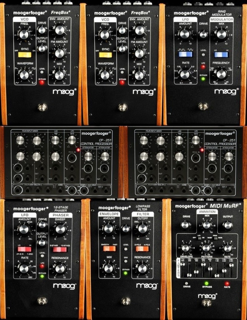

Anyone actually built a modular synth out of foogers?
I own a MF-101 an am quite certain I´ll get a FreqBox and CP-251 within months. These I´ll get because I like to play bass/guitar more than synth, but I like it when it sounds synth-like. But to justify the purchase of the latter two I´ve started to convince myself that this is a great start towards a modular synth. I make music with a MachineDrum, MonoMachine (six track keyboardless sequencer based synth), Rickenbacker-bass and Hagström-guitar together with a handful of effects. So I can send MIDI from the MonoMachine that could control the oscillator on the FreqBox. For this to work I would need a MIDI-to-pitch-CV and I believe a MP-201 could do that job, and more.
So. A MP-201 recieving MIDI, sending envelope-CV´s as well as controlling the FreqBox´s oscillator pitch, which is sent through the MF-101 and a CP-251 making the two foogers come alive. That´s a small, but functional, analog synth with loads of modular possibilities. And getting a second FreqBox for Hard sync, fm or “just” an extra oscillator could easily be added since the MP-201 has four CV-out, and the CP-251 can split the pitch-CV into three. And getting a Phaser, RingMod, ClusterFlux, Murfs would make this a monster! Expensive, but highly modular and with the possibility of audio in, which to me is tha thing that makes Moogerfooger stand out since I like to play my bass and guitar.
This could be done, right? But has anyone actually done it, and used it more than to try it out? Oh, do give me a reason to pursue this goal!

Yes, I understand that it needs a VCA to be useful. I was thinking the MP-201´s envelopes could deal with that, but I´m not sure how. Maybe if the FreqBox audio is routed through the CP-251 and MP-201 envelope-cv could control the volume somehow. Hmmm… :confused:
Well, when an osc is powered, it is oscillating constantly. Presing a key on a synth opens the vca letting it “out”. The only thing that an envelope output will modulate is the Freq, Env amt, Wave, and Mix. So you still need a vca to silence the Freqbox when it isn’t wanted.
Thats why I recommend a regular oscillator/vca until Moog gets around to making an envelope generator/vca module. We have been requesting this for YEARS.
It might be a little more of an investment but if you are headed towards modular anyway, you might as well make the plunge.
However, a Freqbox might work for you but you have to come up with a solution for silencing it. I run mine into a board and mute the channel or turn the volume down, but as I have a sequencer, I really need a freakin VCA to make it more like a true modular. I also question if this is good because the Osc out is pretty hot and yellow lights my other foogers and sends a hot signal to my board also.
Ultimately, I wish I had gotten the osc instead of the FreqBox, but I do use it alot. I just deal with the vca issues, and for what it does I really like it. I don’t really use the FM though.
And, I do plan on expanding my synthesizer with more modules, so this problem should be resolved within the next few years. Maybe by then Moog will have a solution of their own, but until them Im looking at dotcom.

Definitely getting a Freqbox and a CP-251 now. And then it´s a Ring mod or Phaser. With those five foogers (I already have a LPF) I can experiment my way into the next century. A Moogertron is what I want! :smiley:

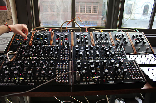

Here’s a recent synth meet that I attended in Seattle. Two of the Mothers belong to friends as well as the MiniFooger Delay. The rest is a sample of my Fooger collection as well as 2 Werkstatt’s and a Voyager.
Does a table full of Foogers work well as a modular synth? Hells yea…
Stephen
They go great with a voyager!
