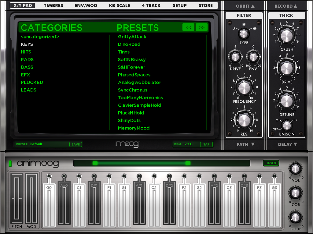

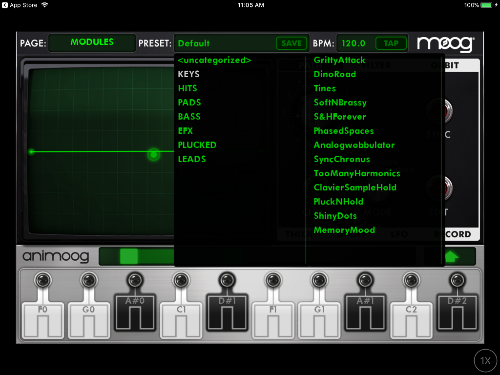

Since upgrading to iOS 11, the categories and presets in Animoog (both iPad and iPhone versions) are no longer listed in alphabetical order. Am I missing something, or is this a glitch with the new OS?
Everything displays properly on my iPhone 5s running iOS 10.3.3, and it did on my iPad Air 2 until I upgraded to iOS 11.

I just updated to iOS 11.1, re-downloaded and re-installed Animoog 2.4.8, but the lists are still un-sorted.
Something must be messed up after disabling the iOS 11 crap that I never use.

Hi Rocky, I confirm I can’t replicate.
However, based on the screenshot you provided, I suspect you’ll be interested by the thousands of Animoog presets and timbres found here: https://www.animoog.org/2017/07/09/the-table-of-animoog-presets-v1-6-released-over-3148-presets-and-5129-timbres/ Cheers – Alex / Satri
Thanks, but I’ve already downloaded them. And that just makes the problem worse.
In fact, out of frustration, I actually wiped my 16GB iPad Air 2 this morning and restored it with a fresh copy of iOS 11.1 and only installed Animoog, that’s why the preset list is so short. I wanted to try it without changing any configuration settings to see if it was something I disabled before. But, as you can see, it’s still messed up.
I even installed the iPhone version and got the exact same results.
Weird!
Just to follow up…
Although Animoog was the first app in which I noticed this problem, it’s actually far more wide spread than that. Along with Filtatron and Model 15, the same random list sorting problem is evident in all the Arturia, iceGear, Kymatica and VirSyn apps that I’ve checked so far. SynthMasterPlayer and ElasticDrums preset lists display correctly, though.
Therefore, I’m sure the problem has nothing to do with Animoog, but rather it has something to do with my particular iPad/iOS combo.
Very weird, indeed!

Yea! Whatever you did, it worked. Today’s Animoog for iPhone update v1.3.5 finally solved the file list sorting issue on my iPad Air 2.
What was the fixed glitch, if I may ask? An undocumented iOS 11 “feature”, no doubt.
For certain devices, listing files in a directory on iOS 11 results in them not being sorted by default.
Since the beginning of iOS, the directory contents being sorted has been an undocumented behavior that just worked, so everyone has been relying on this. Nothing in the developer documentation guarantees this though, so for performance reasons probably, Apple has changed this behavior. Manually ordering the files that are listed in a directory, solves this.
