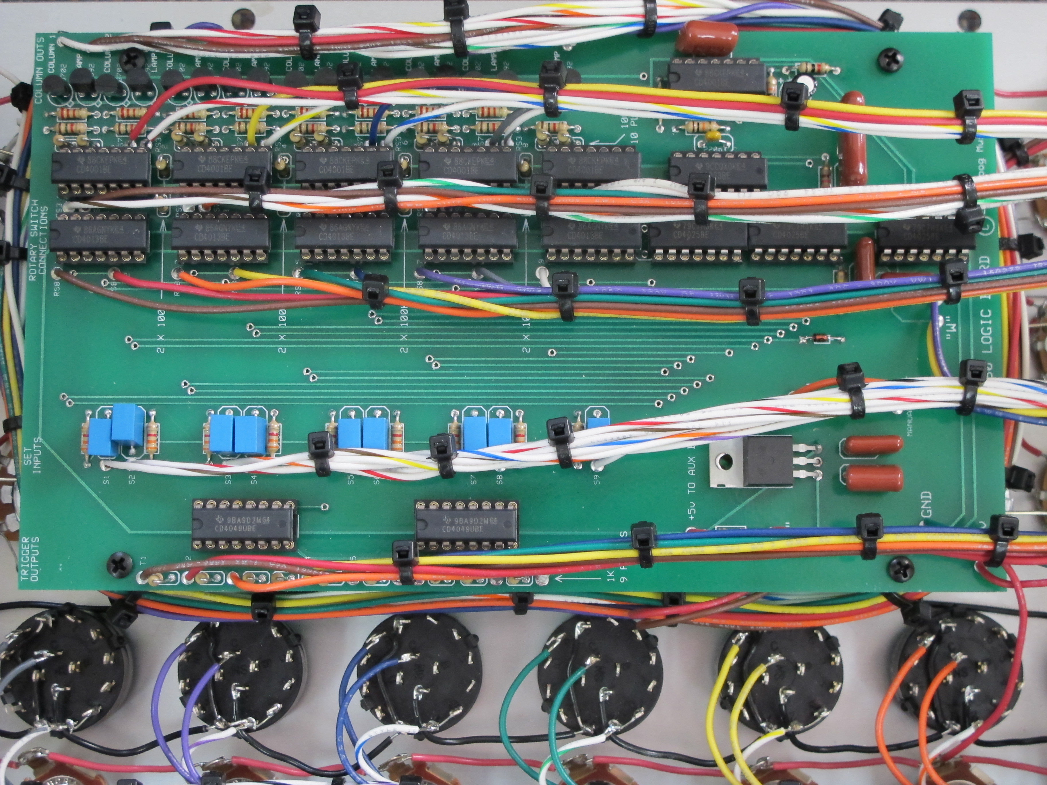

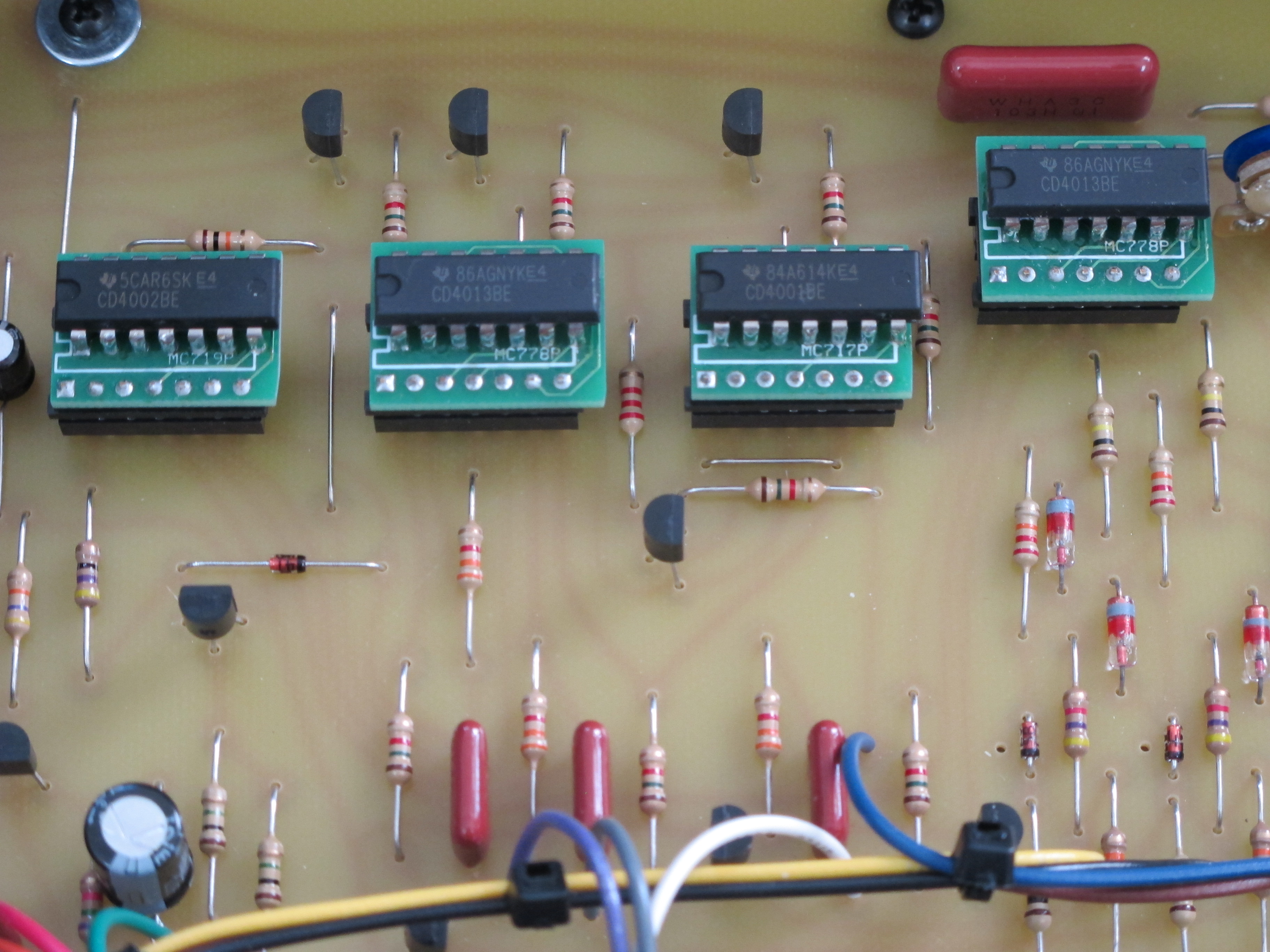

Before receiving the 960 I had wondered what Moog had done about the long obsolete RTL logic chips that were used in the original 1960s design. I remember reading about how Gene Stopp had scrounged around to find enough RTL chips for the building of the Emerson modular clones in 2014 and I was curious if Moog had continued to use RTL in the current products but I was glad to see that they didn’t do so. The main logic board in the 960 has been completely redesigned using 4000 series CMOS running at 5 volts supplied by a 7805 voltage regulator. This is exactly what I would have done had I been in charge of this product at Moog. The 961 and 962 were done differently though, the original PCB layouts were reused without modification, 4000 series CMOS was again used but the different pinouts were accommodated by the use of small daughter boards that each held a CMOS chip and in turn plugged into the socket where the RTL chip would have been. I’m not sure why this was done, it would seem to me that altering the original board layouts for CMOS pinouts wouldn’t have been any more difficult than making a bunch of daughter boards but that’s what they did.

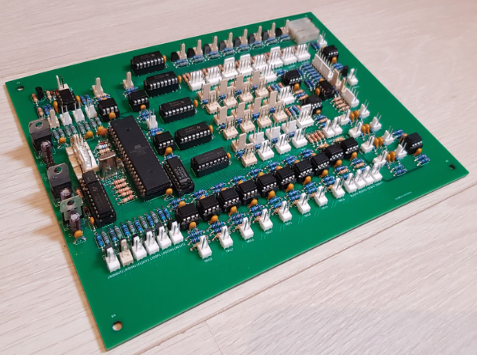

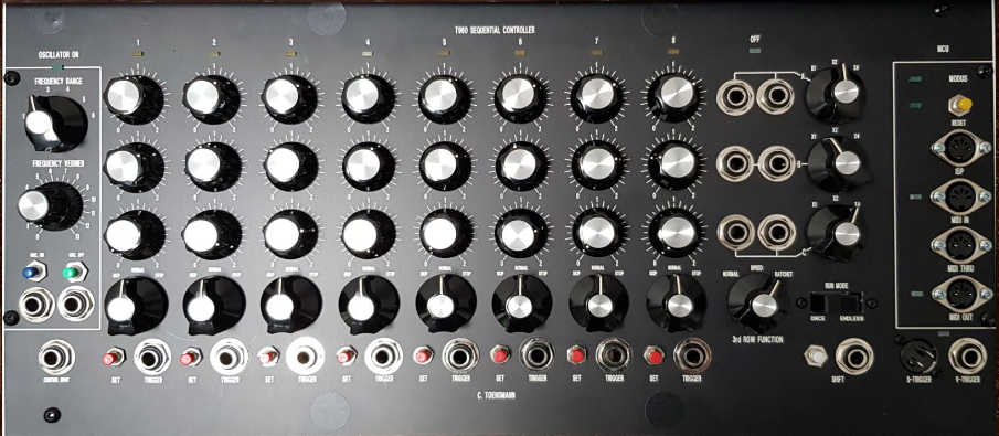

Anyway, (I know I get on people’s nerves with that) I decided to create an own clone of the 960 and replaced the IC grave of the original circuit with a µcontroller solution, so I developed a much simpler board with a fractional amount of current consumption and much more sequencer functionality (ratcheting, 16 x 1, 24 x 1, MIDI capabilities, a complete overview and YouTube demos can be found at http://www.analog-monster.de/mmt960_en.html):
I compared the haptics / human interface of my clone and the original (clone) in its behavior and could not find any difference, so consumer market oriented product policy is fine of course, but selling expensive invisible old fashioned technology in the background without any sound influence or benefit at all I really don’t understand.
I completely agree on your thoughts regarding the reissue of control voltage circuitry. An argument can be made about keeping the design of signal generating and signal processing circuity exactly the same as the original as it could theoretically affect the sound of the instrument, but control circuitry, assuming that it functions the same as the original design, will not affect the sound in any way. A while back I needed another envelope generator and so I built one, but rather than using the '60s vintage all discrete design that Moog used for the 911, I designed and built a functionally equivalent envelope generator that used CMOS analog gates and digital logic chips instead. That design used far fewer parts and consumed less power but works exactly the same as the original.
Your microcontroller based 960 clone looks like an elegant solution that has greater functionality than the original did.
