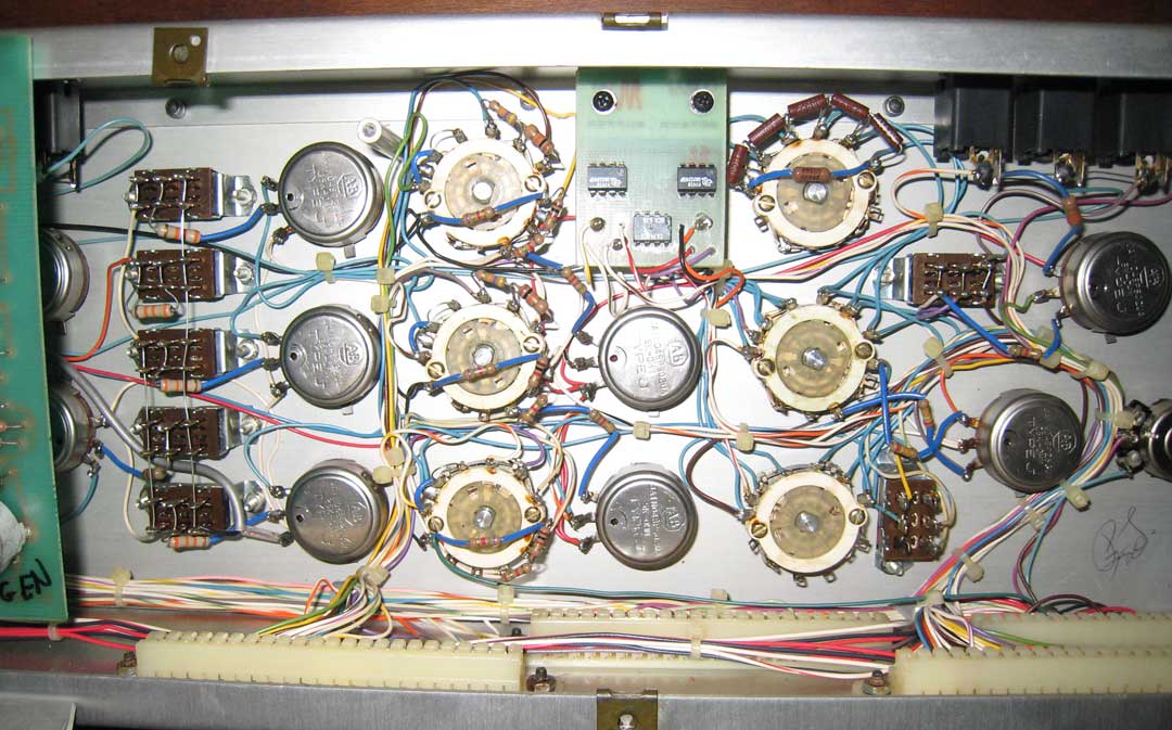

A person brings me a Minimoog D for restoration.
The synth has two screws holding the panel on, the fuse is blown, the power supply blown, the mod section is shoved into the wood and EVERY sealed pot is drilled in the back with a large diameter drill.
The whole thing is loose, beat up, dented, etc.
It's a horrible Mini to restore because so much needs attention and I tell the client this.
He then says it was "perfectly in tune with super stable tuning" before he brought to me and declares me a moron and liar.
Merely tapping on the vco board makes the vcos sail out of tune.
The trimmers are shot.
One can't even adjust the front panel tuning adjustments to a zero beat and have it stay there for more than a few seconds.
No matter what I say, he can't fathom that his Mini could be anything like I've described.
Not only that, but it must be my fault as well.
I'm astounded because this guy restores Rhodes and we talked shop about all the many problems each unit can have and how often clients think their instruments need little attention and then he turns around does exactly the same thing.
I took pics and video of this thing and many of these problems.
Should I post them?
It shows exactly what's wrong and why.
Anyone with half a melon on their shoulders can see and hear these problems.
Most of the tuning problems are due to all the bad pots and trimmers, but he blames me instead because he's sure those parts can't cause tuning problems.

My wife had a theory too and it's supported by more than one bit of evidence....
What if he tried to fix his own mini, drilled up the pots himself, sprayed in whatever he did, then put the cover back on with two screws to check it out?
The power supply died most likely because the back panel was loose and allowed to short against the heatsinks.
With this scenario, he'd wind up with a bad synth, power supply blown and looking for expert help at this point.
And when the expert said it was ruined, he had no one else to blame because he himself caused the problems.
Curiously, I mentioned these drilled up pots several times to him and he never said anything other than ask what it would cost to replace them.
He didn't blame anyone or ask any questions at all, which is odd taken in retrospect.
He seemed to accept that they were ruined.
It really does appear that he did this himself and screwed up his own synth.
Anyways, I know the tech who worked on this unit previously and sent him an email last night. He replied today that he didn't know who the guy was and even if did work on it, it was at least 6 years ago and very likely needed service now.
I think my wife might be right.
He probably screwed up his own synth and is upset he has nowhere to go now.

Tech note: the rectifier board that I repaired has 8 parts. I replaced 7.

Anyways, here's a pic below.
I have videos, but they need to be edited and spliced together and I'm really not into dwelling on this.
Some background, btw:
Minis used many military type pots that were sealed.
(very early Minis used ALL sealed pots, btw- later ones didn't.)
To clean a pot in a traditional manner, one sprays some solvent in them and exercises the shaft.
But since these are sealed, there's no way to get the solvent in.
So holes are drilled to gain access.
Problem is, the metal bits from drilling fall inside.
When the solvent is sprayed, it forms a small lake in the bottom of the pot because down there, the pot is still sealed.
Then when the tech rotates the shaft, the metal bits floating around are allowed to grind into the resistive element and wiper, causing abrasion and scratches.
The trick DOES work temporarily. The solvent cleans things up and there's not enough abrasive damage done yet to cause noticeable problems.
But later this damage continues to get worse and the pot becomes ruined.
Some techs think this is great because the client picks up the unit, pays for it and they can demonstrate right there it's working.
They're absolved from blame because.. you know... "you saw it working on my bench!"
Many techs even think this is a good practice because they never see what problems it causes.
They drill, spray and can honestly believe it improved the problem because that's all they ever saw.
The unit leaves, they think all is well and that they cured the problem.
http://www.minimoog.net/potholes.jpg
I guess if you work on roads, you remove potholes and if you work on Rhodes, you add 'em?

I found your description of the pot hole problem fascinating, and I realize that I would excitedly read a book about such things.
Wow, Moog geeks are so geeky, we would thrill at reading Moog repair stories! You've got a market, Kevin!
