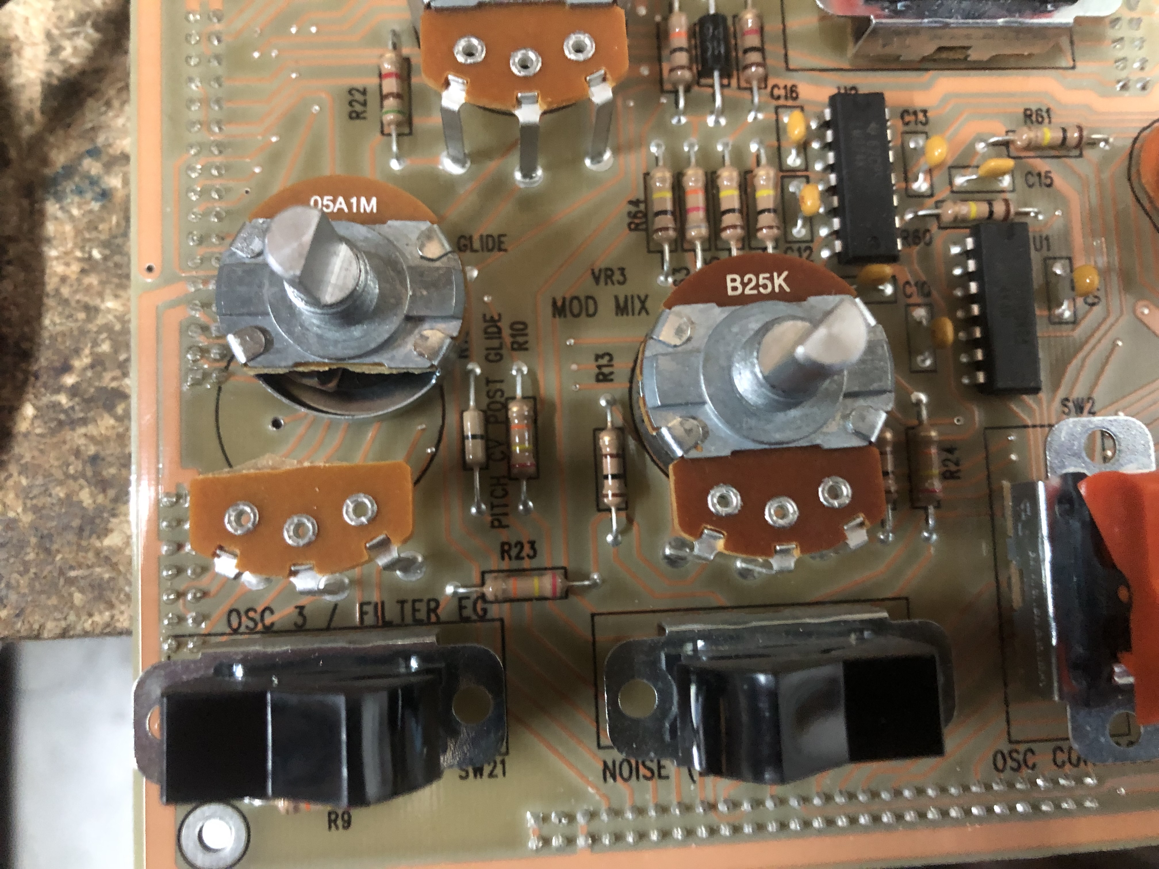

Solved (by my Tech):
Should be up and running with a replacement pot soon.
Glide potentiometer is cracked in two and needs to be replaced. Should be up and running with a replacement pot soon.
