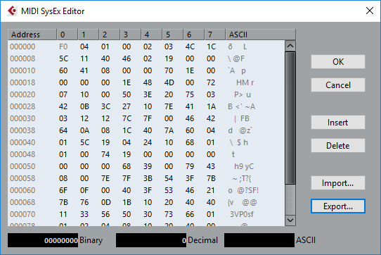

Here's factory preset G23, "School Bass" recorded a few months ago:

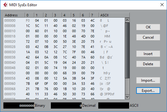

And here's the same factory preset recorded today:

MC, you're right:
the first example is a preset dump and the second one is a panel dump.
You can see that on byte 4: 2=panel dump and 3=single preset dump
