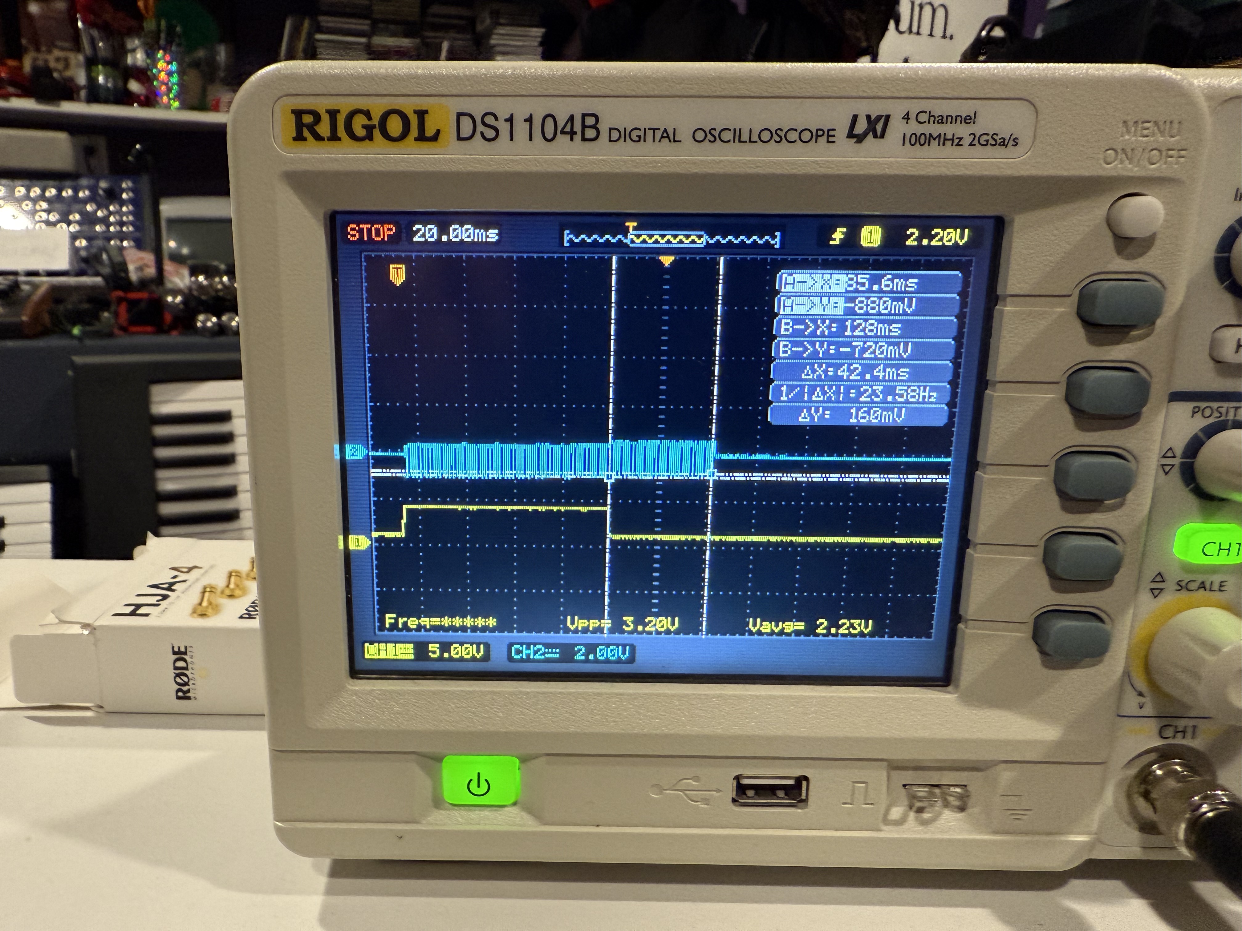

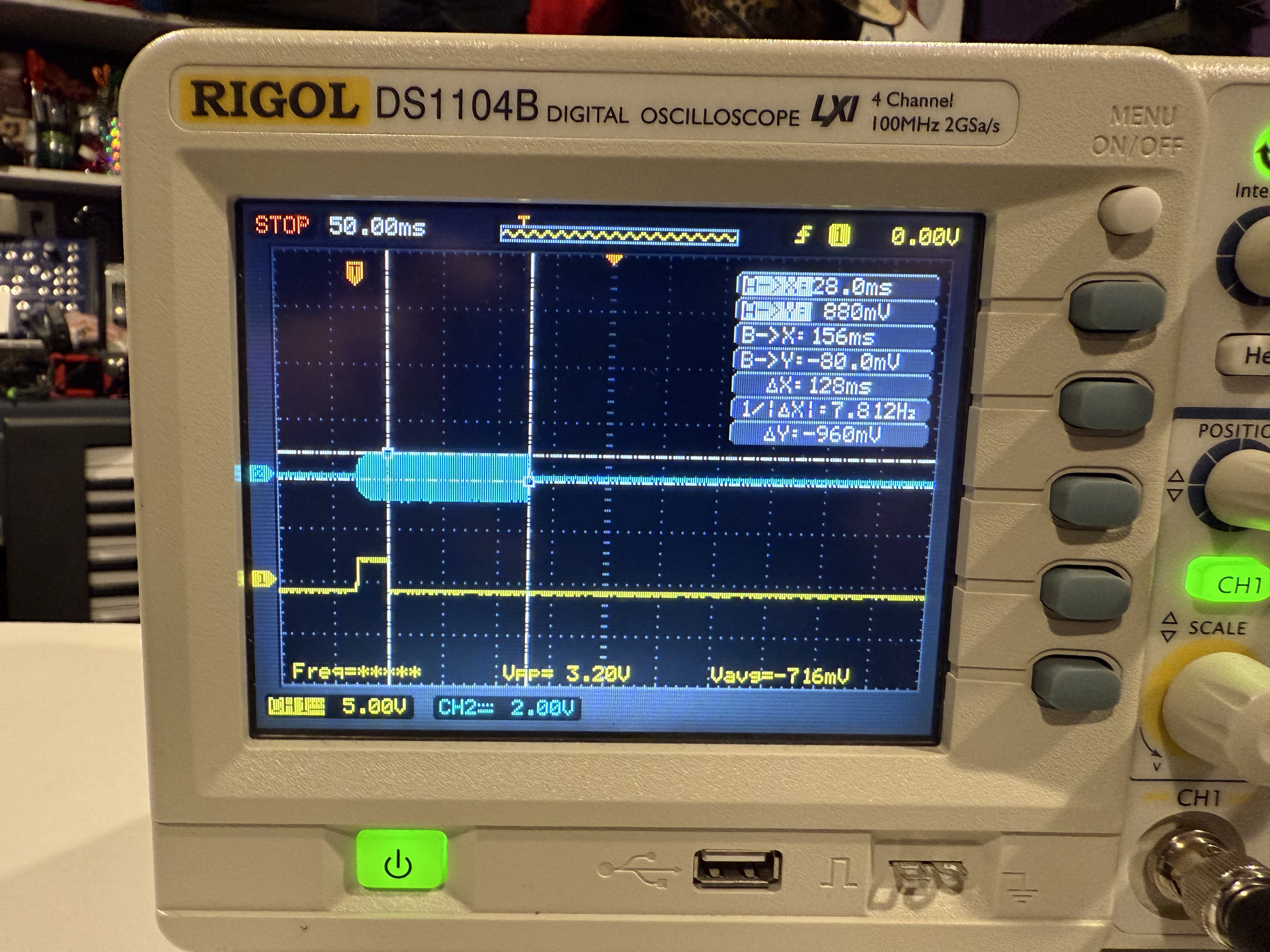

According to Moog tech support, extending the paraphonic note gates after key release was intentional to avoid copmletely missing quickly played notes.
I did some measurement and compared Matriarch's paraphonic gates to a vintage KORG Mono/Poly.
Here's the Matriarch response to releasing the 2nd key in paraphonic mode, and Osc 2 actually muting. It's about 125ms from key off to mute. Here's the Mono/Poly doing the same thing. Note that it mutes Osc 2 about 40ms after key release. Consequently the Mono/Poly feels more responsive to paraphonic playing than the Matriarch.
Making the paraphonic gate hold time configurable in global settings would be a nice solution.
