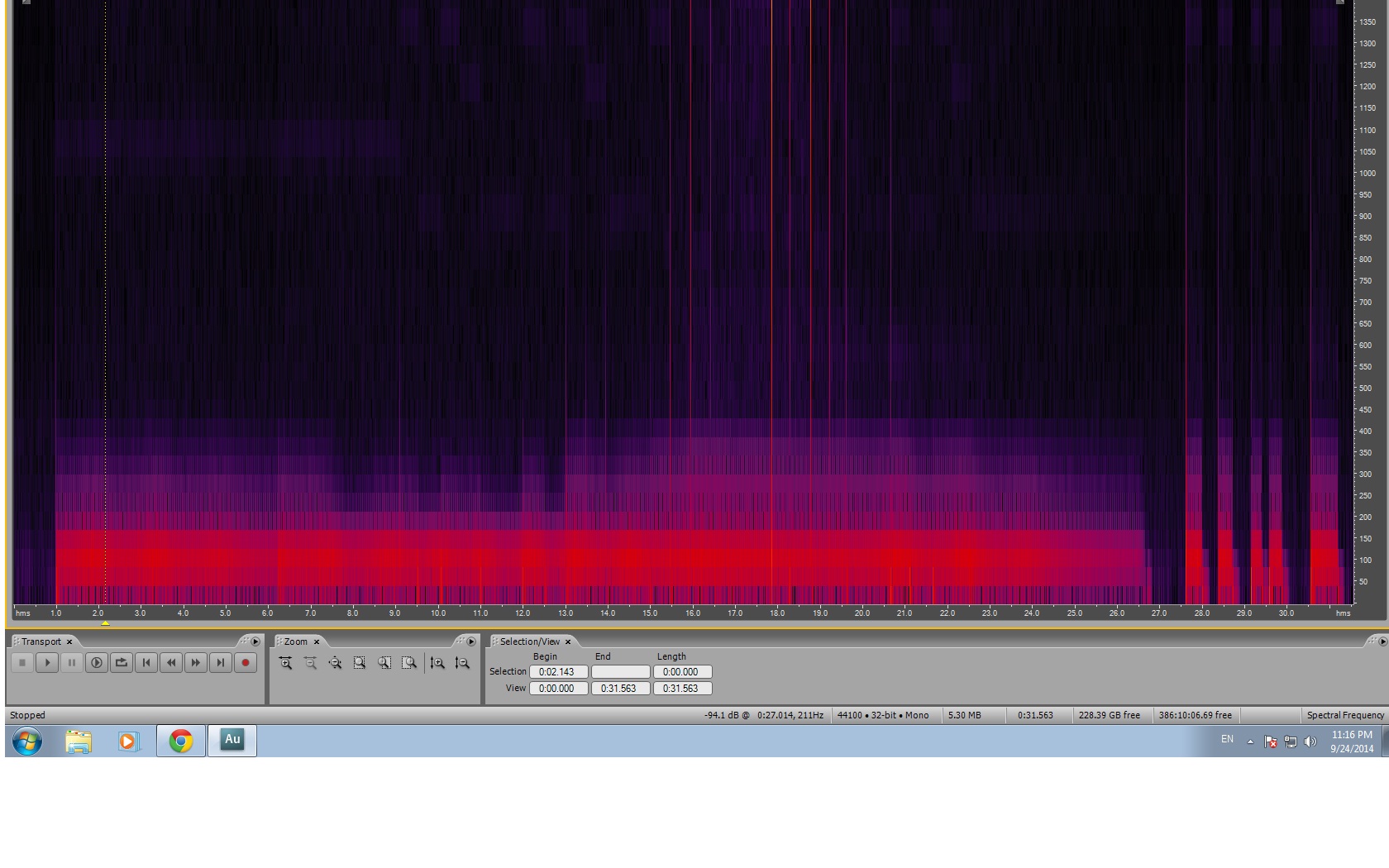

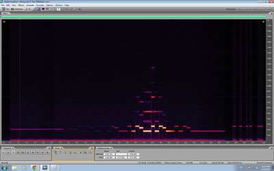

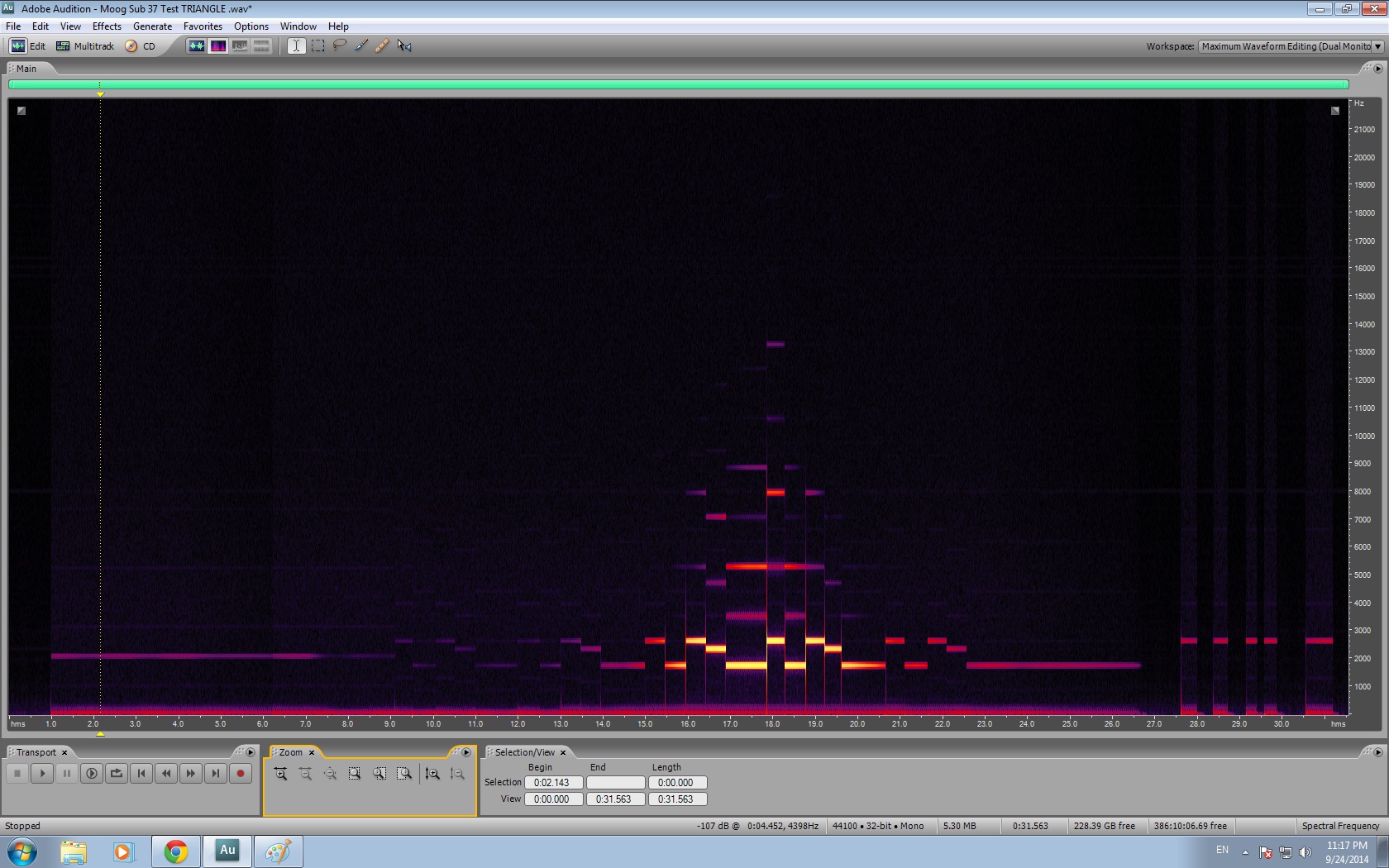

Hi. I have my Sub 37 only for 7 days.
Firmware 1.0.3
I CAN HEAR THAT BUZZ (HUM) SOUND. As I read the forgoing topics, it seems to be a common problem for Moog Sub 37 units.
I tried to make a simple sine wave like sound using the triangle waveform and I used the following setttings:
OCS 1 - 2' triangle max volume on mixer section
OSC 2 - 2' triangle max volume on mixer section
Sub osc - 0
Noise - 0
Feedbck - 0
Cut off Filter - 320 Hz --> 80 Hz
Reso - 0
Multidrive 0
Slope 24 db
EG amount and KB amount 0
Filter ADSR - 10, 0, 10, 10
Amp ADSR - 0, 0, 10, 10
No LFO 1 & 2
and the HUM appeared. I did't noticed this problem before, when I was surfing through the factory presets.
And yes, the hum is present between the triangle and square waveforms. (12 o'clock position on the wave shape button).
I tried the same settings on a Moog SubPhatty and the hum is not present. The sound of the Sub Phatty is much clearer.
I registered my Moog on Moogmusic and described the problem yesterday (friday the 26 th of September). No answer until now. I hope I will get one monday.
Sadly that hum is bothering me, and I am disappointed becouse I was waiting for this synth so much. However I don't want to send it back, I would keep it and I will filter the hum out of my recordings using an EQ.
I hope that Moog will correct this issue with the next firmware update. ... and I hope the Moog will include a feature that shows the exact bpm rate on the LCD screen, as it was on the Little Phatty.
Please check my attached files.
