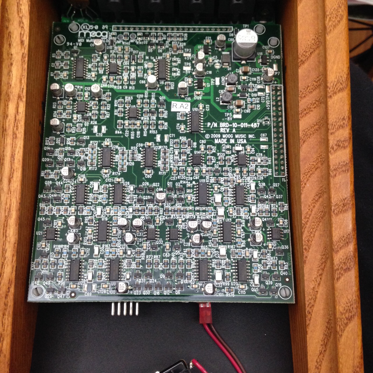

Hi folks,
sorry to dig this thread out.
I would like to know how to set my Midi MuRF to stereo out when bypassed.
Had open the back and this circuit thing do really confused me.
I couldn't identify the jumper to flip. Not sure whether the Midi murf could do the same adjustment.
Suggestion needed! Thanks

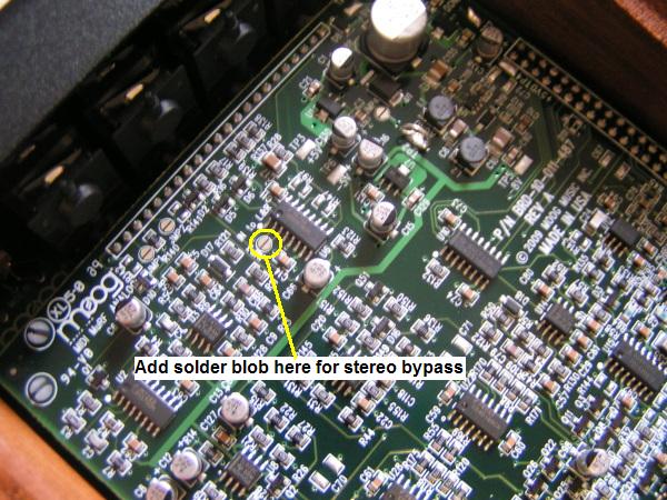

_DemonDan_
- Posts: 1273
Post
by _DemonDan_ » Wed Apr 27, 2016 12:32 pm
Just follow the magic footprints...

HaloHalo0407
- Posts: 8
- Joined: Fri Dec 30, 2011 6:12 pm
Post
by HaloHalo0407 » Wed Apr 27, 2016 1:46 pm
_DemonDan_ wrote:Just follow the magic footprints...
Wow! Thanks for your reply, though it looks super tech difficult
I guess I should bring my murf to tech worth trust to see if he can solve this soldering thing for me.
Thx

by HaloHalo0407 » Wed Apr 27, 2016 2:01 pm
And thanks for the pic labeling out the exact place to solder.
Now this quote make sense to me lol.
Amos wrote:The short answer as to whether it would be OK to solder a switch to the Midi Murf to enable mono/stereo bypass mode-switching is... I haven't tried it, so I don't know. But it sounds like it would be OK.
Yes the pads are labeled: "IN to L&R" above the pads, and "JMP3" written vertically to the left of the pads. Location is upper middle of the circuit board as you look into the underside of the pedal with bottom plate removed.

_DemonDan_
- Posts: 1273
Post
by _DemonDan_ » Wed Apr 27, 2016 5:51 pm
DonutDude wrote:Not sure that is what you are looking for but thought I'd mention it before you start soldering an expensive Moogerfooger board.
It's actually very easy to do. Just get a small blob of solder on that bisected pad and it's done.
