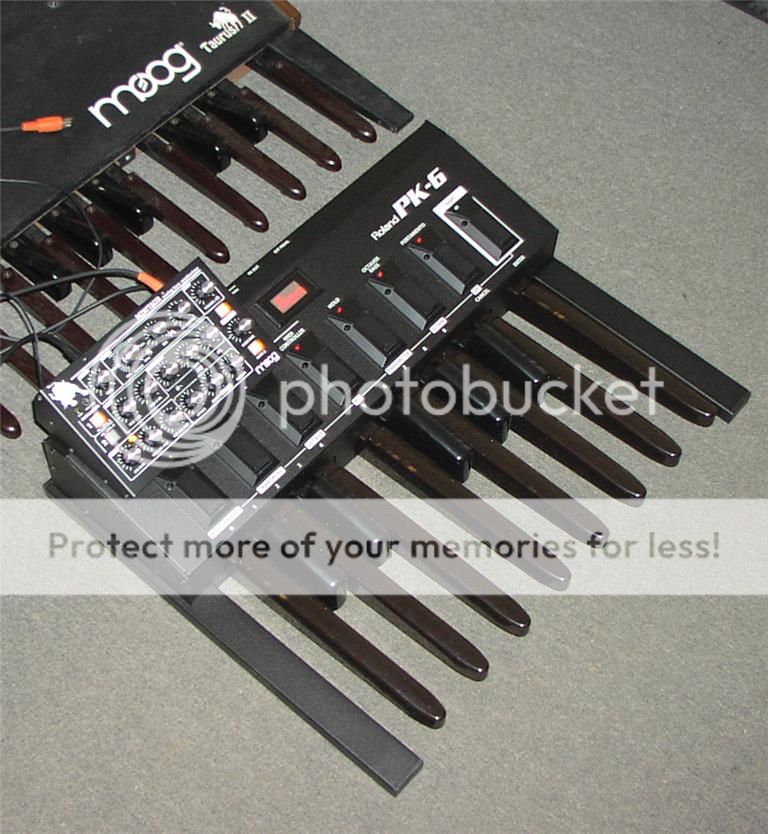

When either working on CVs or din-midi and not messing around plugging midi cable when Minitaur is on, everything is fine and so I am.
Plugging anything into the Minitaur patch cable or expression pedal or else while it is on, it gets into all sorts of strange behaviour : mod section freezes, pitch is off by a mile. Best avoided. The behaviour of the controller (when midi) is to be taken onto account too.
So if that is that, that's what it is.
