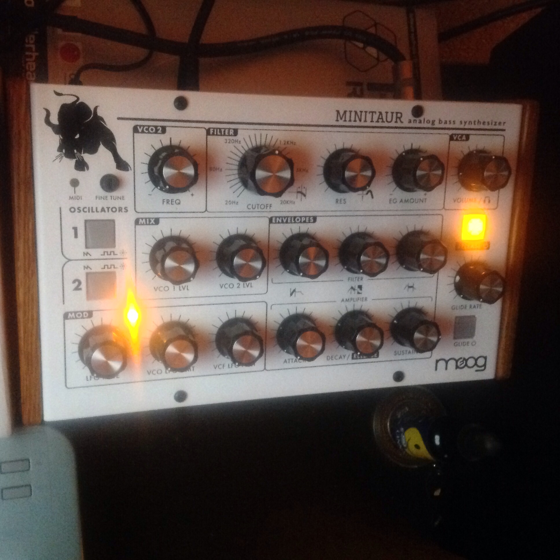

I just bought a Minitaur LTD. After I registered if, I got an email to load v2.1.1 and editor. When I do the power on sequence and release them the bottom light never blinks! I did the down loads,and I can see the editor knobs move when turning the hardware and vice versa. I did see a post that had all the presets you could load via midi. The lights on the Minitaur blink, but after it's done I can't scroll thru the sounds!
Am I missing something? This is done on a iMac BTW.

I got in touch with Andy from Moog tech lab. He was able to sort out my Minitaur, so I want to say thanks to all the staff at Moog! The forum is great, but I would recommend using tech support if you have a problem you can't figure out on here.
