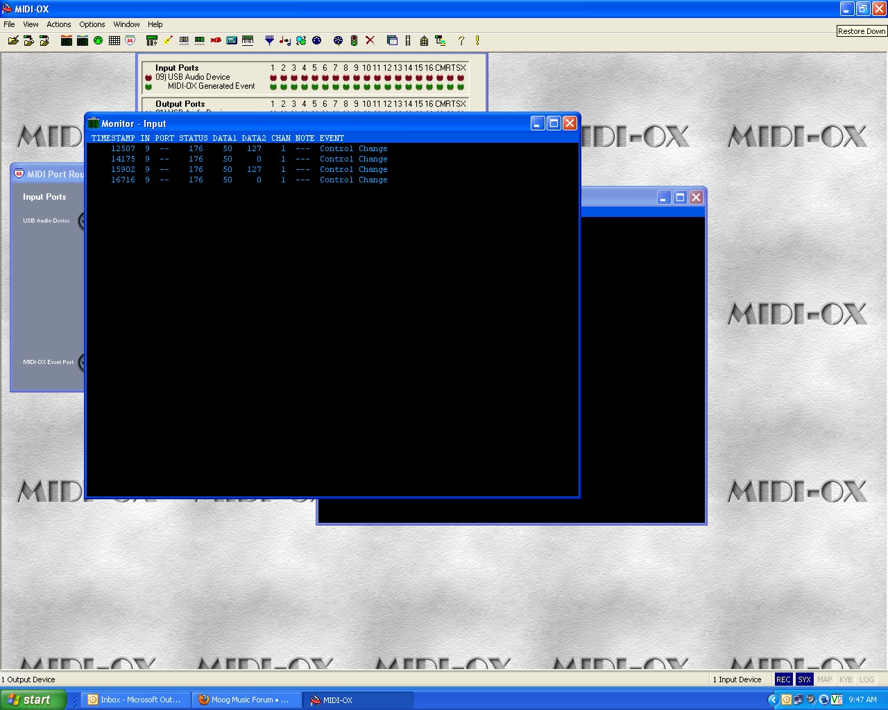

Hi Teddy -
I grabbed a unit and tried it out - It does definitely send the correct values - 0 and 127 when you set a Channel to the settings we discussed. I attached a screen shot using MIDIOx showing the MIDI output of a channel set to these settings. The only difference is I'm not using the USB MIDI port - but that shouldn't matter.
So I looked @ the M9 manual -It says you are toggling between record and overdub with these two messages - when you send the CC#50 Value 127, it should start recording a new loop - then when you send the MIDI CC#50 Value 0 it should start the loop from the beginning in Overdub mode (playing but still recording). I don't have an M9 so I can't confirm.
Have you confirmed that this function works on the M9 with another MIDI controller? I'm baffled why it would not respond to the MP-201s MIDI CC50 value 0.

Re: latch toggle between 2 cc values?
thanks for investigating !
the MP201 IS sending a bank message every time I hit the button with a 127 value...
confirmed with logic's midi monitor
I see in Midi Ox when you do the same it doesn't send bank message... must be something in my settings, no?
