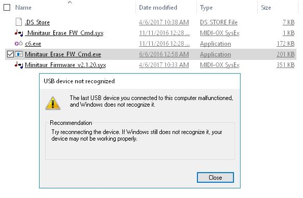

I think I've got a problem with the driver. Win10 - Minitaur shows as installed, but I get a 'usb device not recognized' message,
and a note to unplug and replug, which produces no results.
When opening up the sys-ex program, I get 'no input' and 'no output' selected messages when clicking 'send sys ex'.

This is your problem -- the driver doesn't work until/unless you update the firmware. Driver doesn't work with old firmware.felis wrote:I get a 'usb device not recognized' message,
I was unable to erase and load in new firmware
Simply uninstall the driver, then try updating the firmware (if you want to be a beta tester) without the driver installed. Only install the driver if you've already updated to the new firmware.

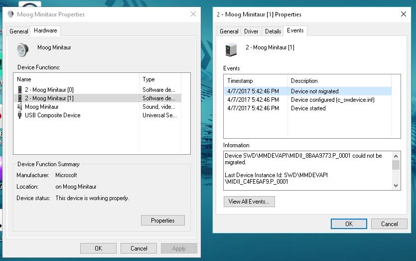

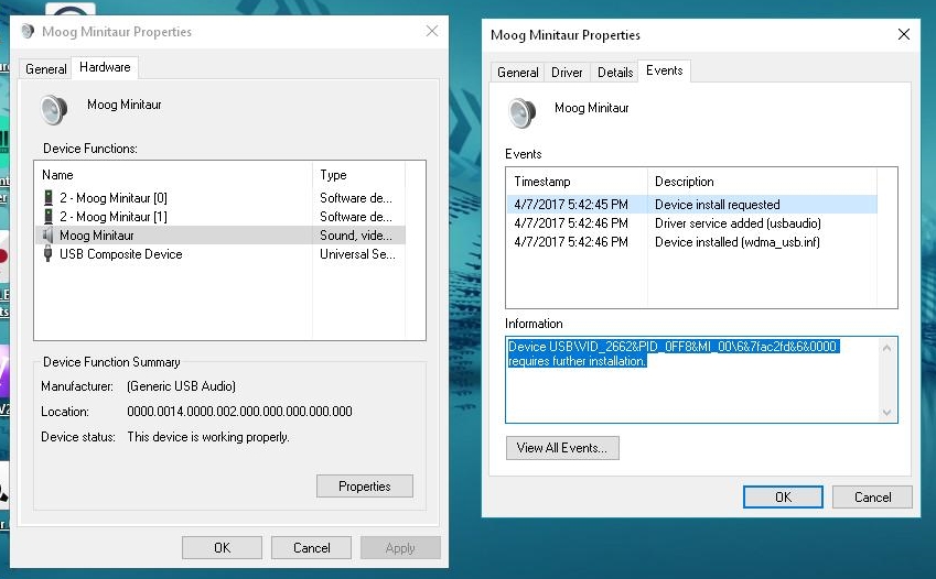

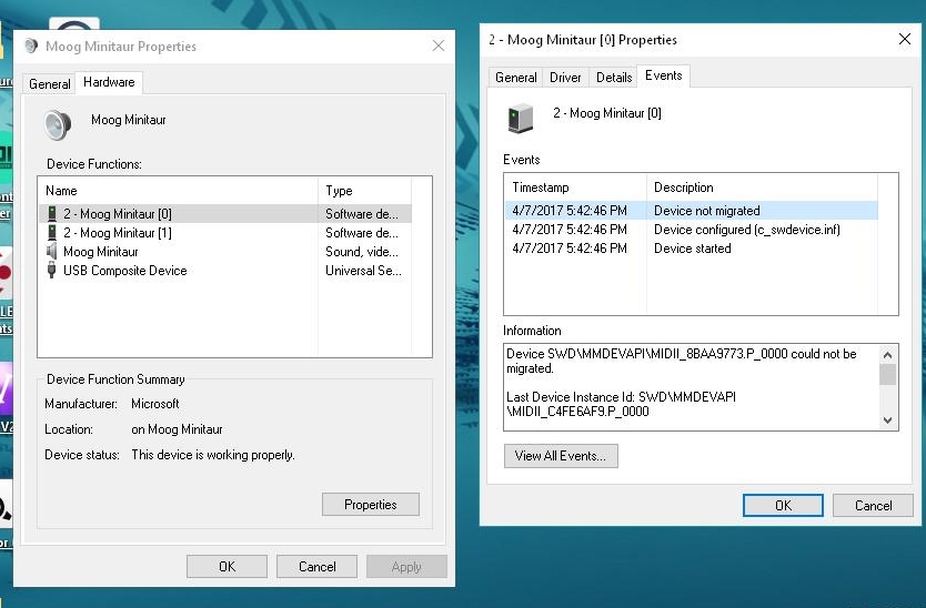

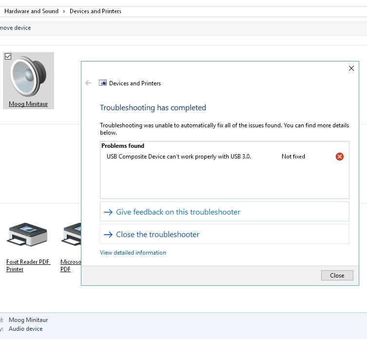

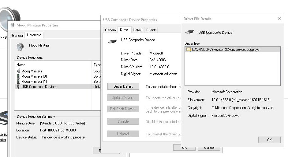

OK - thanks. I guess I was given the wrong directions:
I tried what you said. In case anyone's interested I'm including some screen shots of what I get with Win10 when I let it automatically install the device.
This is under the 'view devices and printers' area.
The device shows as installed, but I can't select input and output because further installation is required.

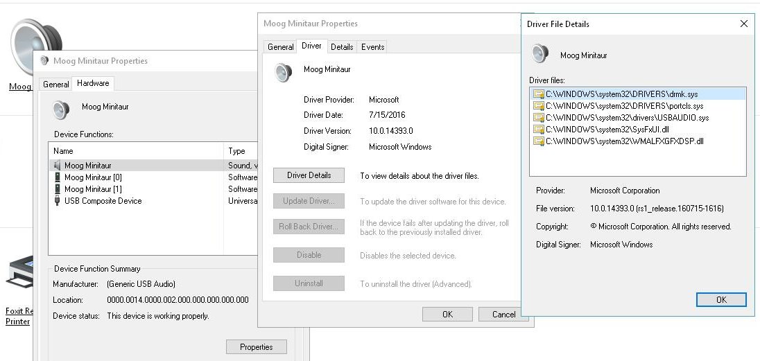

One more - won't fit in the last post.
The editor works fine standalone and in Cubase on win10.
I just can't get to the ports to change the firmware.

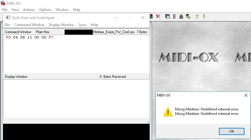

Did you read the post from Amos? He says - "... Only install the driver if you've already updated to the new firmware...".
My current problem is that I can no longer update the firmware - midi-ox and C6 don't recognize any inputs/outputs.

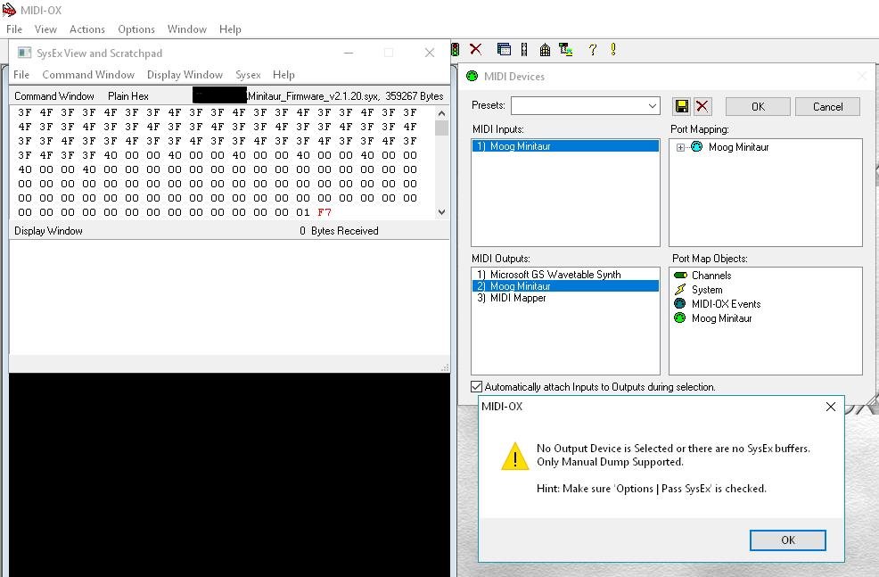

Very sorry for clogging up the forum.
I can't be part of the beta program, because I can't get midi-ox or c6 to recognize the ports on the Minitaur.
I searched the computer and deleted most all Moog files/folders, then plugged it in.
I looked like it was installing, but I got the same notices as above, the device is not migrated and needs extra installation.
I'm posting some shots of the port errors I'm getting when selecting the Minitaur in those programs,
in the unlikely case that it spurs some ideas from anyone who has seen something similar.
As above, click the pics for a clearer view.
