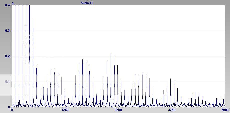

The first eight harmonics of a guitar string (and lots of sub-harmonics)
Sorry for the bad graph quality, I just plugged in a guitar (SG 61 re-issue, neck pick up) straight into the computer, plucked an open E a couple of times and selected a 8192 lines discrete sample almost at random from the recorded waveform. This test was done in about 3 minutes, including set-up and plugging the guitar. So there it is.
Edit : this graph does not represent what it is supposed to due to wrong audio card settings (see explanation below). But it's nice and a good example of FFT analysis so i let it here. Other nice Images of sound here.

What's your starting frequency (which open E...)?
As best I understand it, sub harmonics should not show up unless there's lot's of distortion either in the guitar electronics or the computer interface.
Also, not sure the point you're making with this graph. Could you elucidate some?

^ The point you ask ? Experimenting and learning are fun, need I say more? And for the reader, a picture is worth...
Anyway, due to your keen sense of observation, the above graph was wrong. The test was made so quickly, i just boosted the microphone entry by 30 db on the sound card and removed special effects. I had never measured a guitar string before. On the first try, I was surprised of the high content of sub-harmonics, but I thought the result matched the abstract of the project so well I posted without verification.
The wrong setting on the sound card resulted in an AC offset, which actually turned the waveform in a sort of square-like form wave, hence the high content of harmonics.

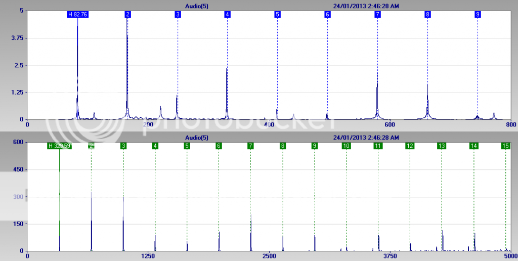

Here is a better and verified sample. Top graph is Low E string (tuned maybe a bit sharp) with 9 harmonics and the bottom graph shows 15 harmonics for the High E string. Very little sub-harmonics were found this time. Both graphs were produced using a custom integration filter to raise the level of high frequency harmonics and make them more easily identifiable. I would not have bothered to code such a filter if it had not been for the first mishap so I now have a new tool in my FFT analysis toolbox. Thanks. 8)

Thanks, that makes a lot more sense.
