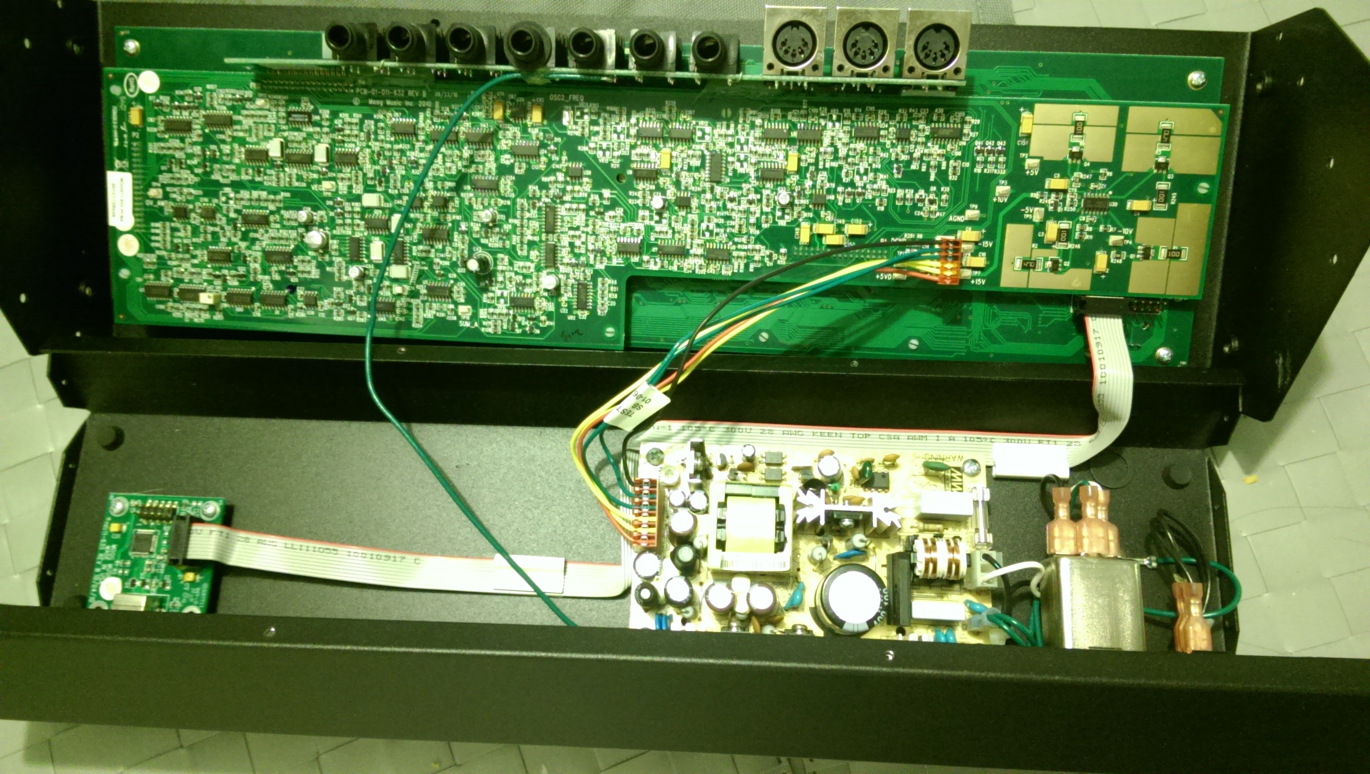

My slim today when I plunged it a Cv/gate cables just died.
Screen has no text and is just white, the controls don't change when I turn them and none of the buttons work.
Holding the master button while turning on the unit dosn't load the debug so I can't load the firmware.
Is there any think I could do ?

I have opened it up, and have ordered a debugger, I just need to find out where I connect it to. I have seen it done to a little phatty but it's a lot different in side.

Used the debugger with some institutions from moog and it's all fixed now :)
