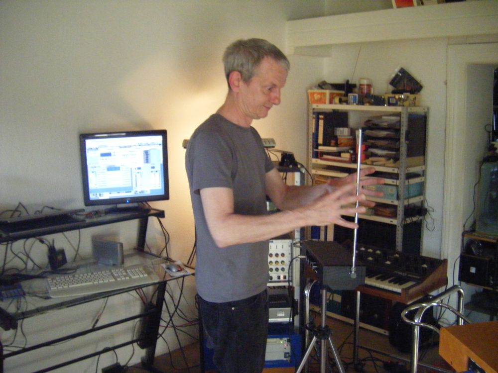

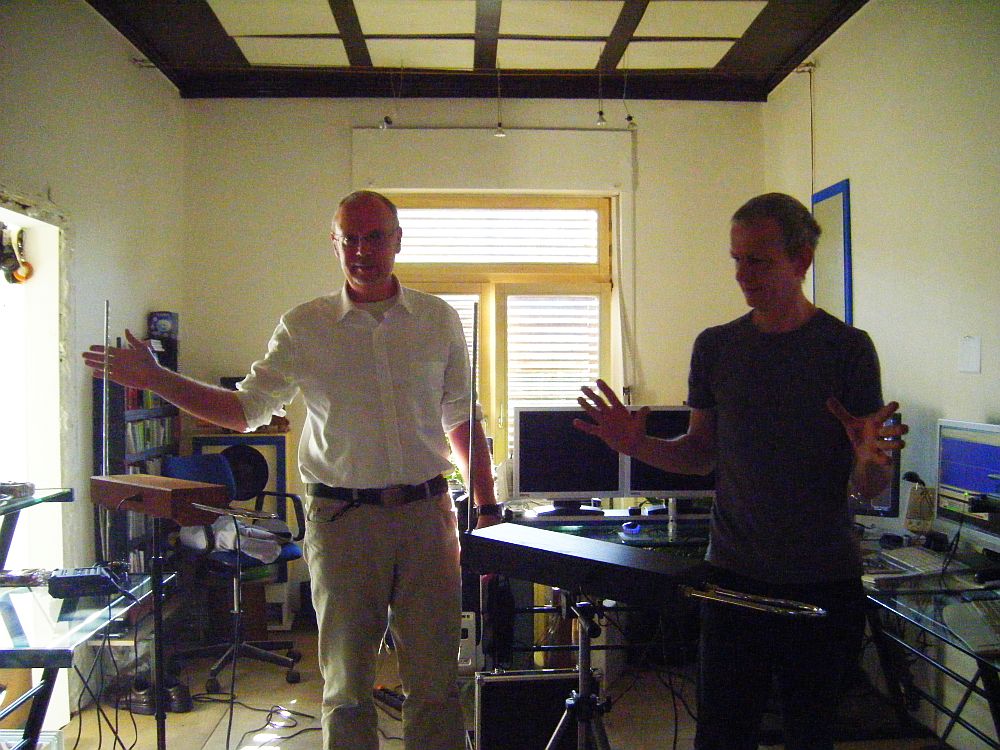

just an update. We've had now our first Theremin duo session. As expected quite stressful so far as the arms and shoulder movements were concerned. Because the Theremin always produces sounds if the player stands close to it (and not touching or approaching closely the curved left antenna) we played more than one hour continously and moved our extremities and sometimes excercised even head banging movements towards the upright scale antenna. Now I have nice aching muscles and a nice SD card full with strange and never repeatable etherwave vibrations. In fact one of the most difficult issue is actually to keep a certain tone to a constant frequency I think.
Interesting also was to stand between two Theremins and played these two instruments simultaniously by one player. A duophonic set up was achieved which worked very well. For the next time we'll consider to use a stereo volume pedal to achieve the dynamic control as well (unfortunately I only had two arms on my body which I used both for the upright scale antennas). Or maybe I should lay down on a couch and control the volume antennas by my legs (?).
Anyway it was a great pleasure and a lot of fun. And a related video will follow soon (will be published by Harald soon). And here now two fotos as a teaser already:
