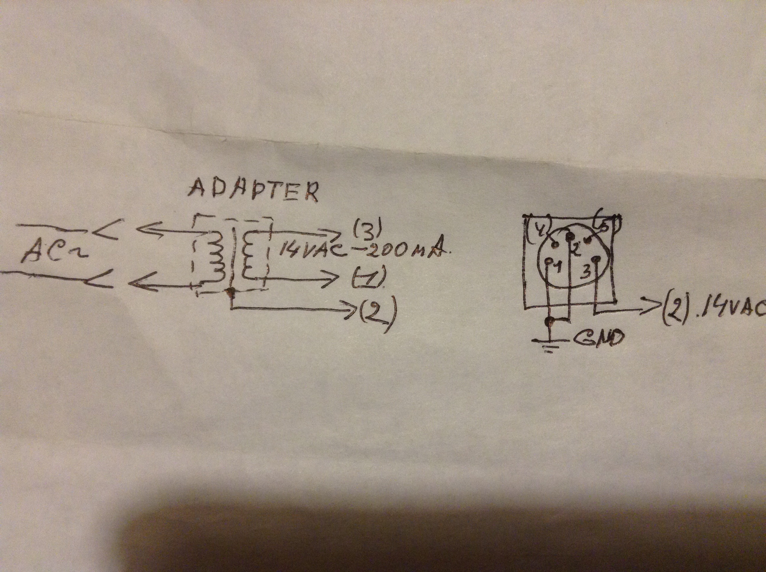

The adapter is a step-down transformer AC to AC. With the output 14 VAC, 200 mA. You can use a 3 pin connector, since the pin 4 and 5 are not used. Attach a drawing of the electrical circuit.

thanks valery for that beatiful drawing!❤️ xactly what we've been looking for.

Valery wrote:The adapter is a step-down transformer AC to AC. With the output 14 VAC, 200 mA. You can use a 3 pin connector, since the pin 4 and 5 are not used. Attach a drawing of the electrical circuit.
I second that thank you, Valery. I came to this forum specifically for that answer and your wonderful drawing helped me a lot. Thank you - Tom Falater

Hello! I accidentally made a mistake in the numbering of connector theremin (right picture). You need to define counter-clockwise: first from right, third from the left. But on the schema the adapter is not affected.
The design of the adapter is correctly.
