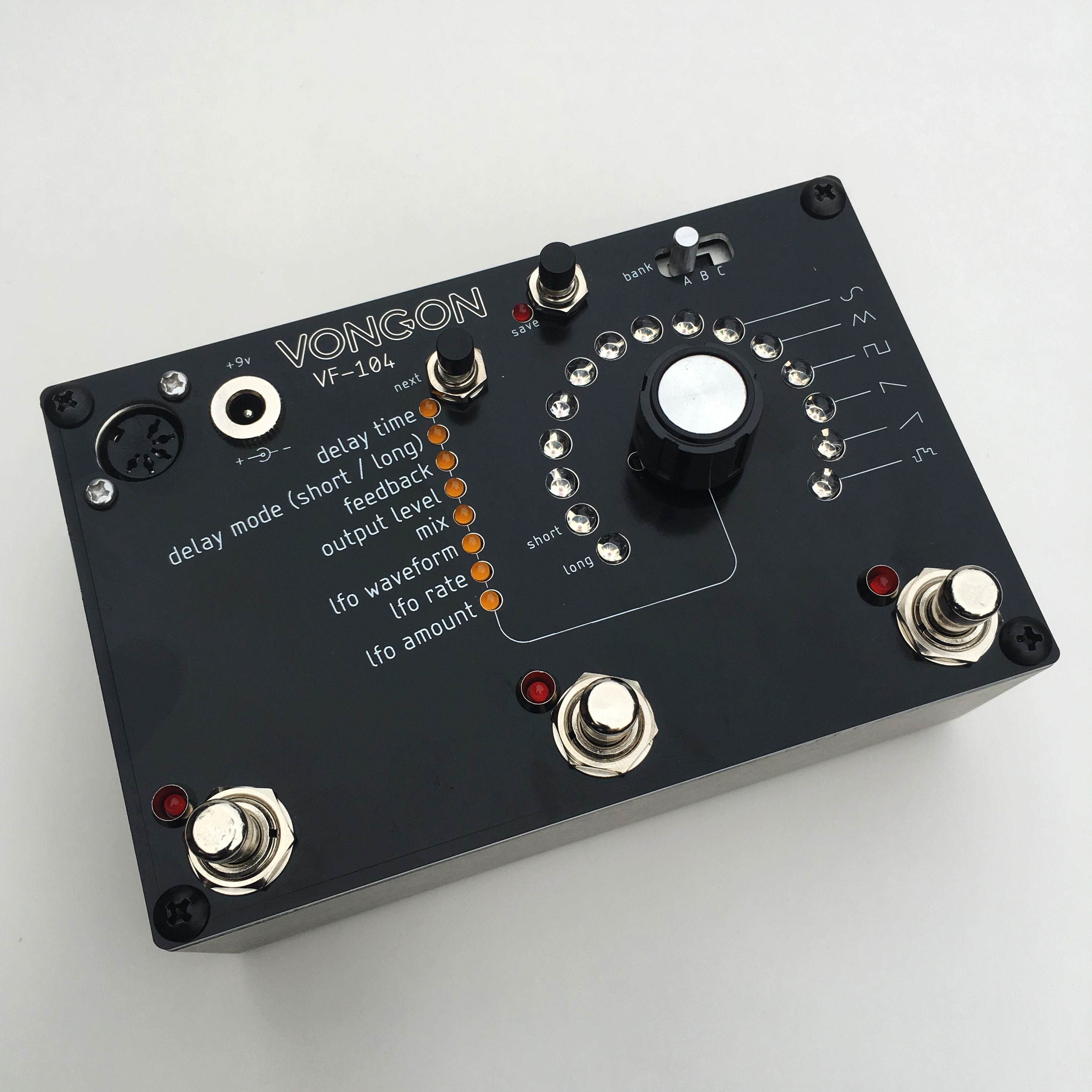

Just wanted to chime in that I make a midi controller exactly for this purpose. They are preconfigured to work out of the box with either the MF-104 or MF-108. Very useful for saving / recalling presets and performing live. The video linked below shows how to operate the midi controller and gives some suggestions for different creative ways to use it. Would love to hear what you think of it!
I make these by hand and currently have about 9 ready to ship.
demo video: https://www.youtube.com/watch?v=iGnVd1EHBIs
more info @ https://www.vongon.com/
