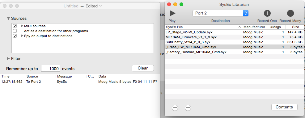

i tried to update firmware 1.1.3 following the instructions
after bootloader mode (3green LED) I can't erase the current firmware, since the LEVEL LED is not blinking yellow three times. Neither can i send the "Factory_restore" command.
I use a Motu Micro Lite via ELektron Overhub and Sysex Librarian from snoize.com I dont't have much experience with sysex commands. so I attached the Midi Monitor screenshot.
- i tried with port 5 and port 2 MIDI out of the Motu
- i changed MIDI cables from cheap sssnake to a cordial. (3m, 5-pin)
can you help me out. thanks a lot
