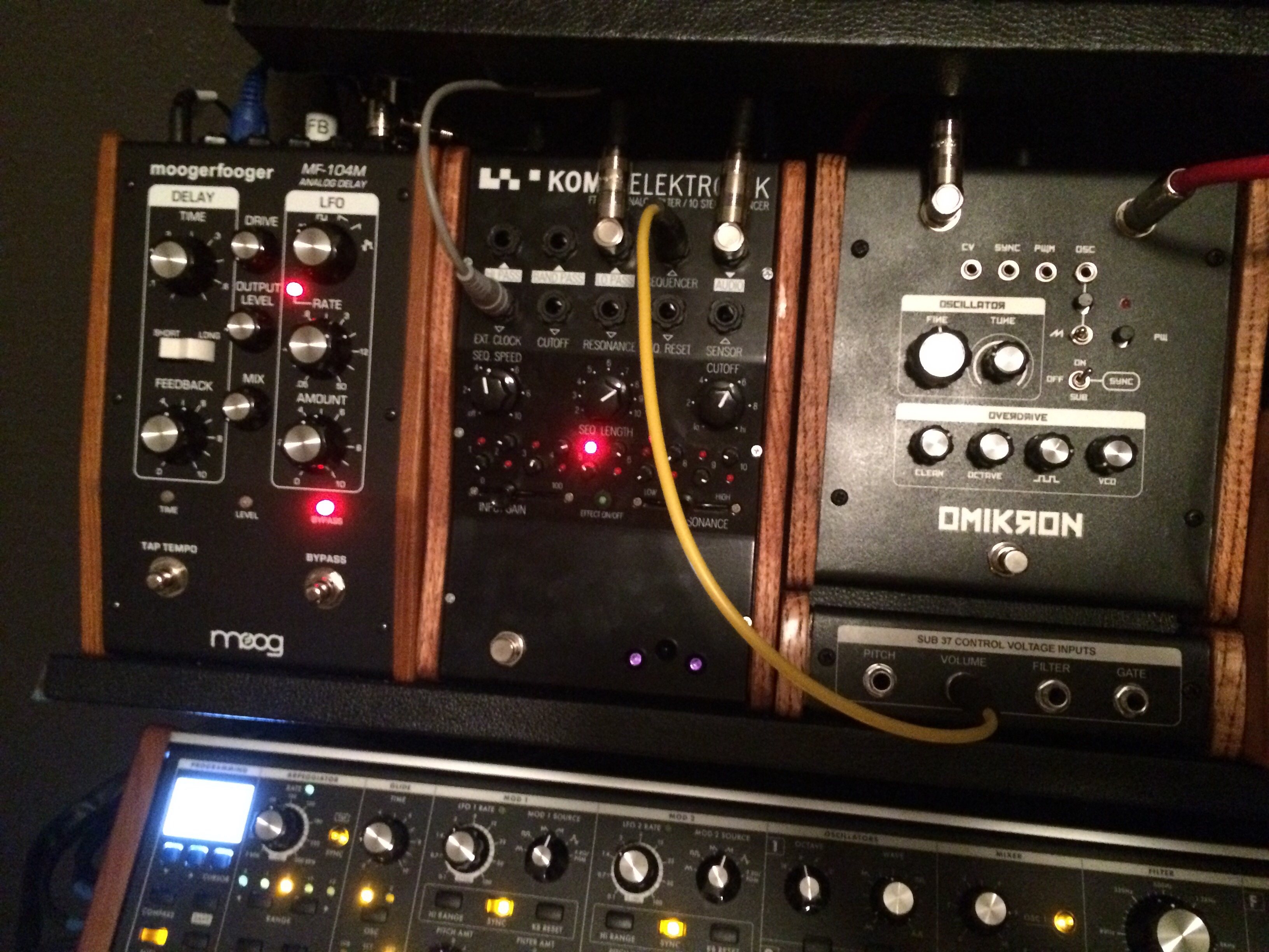

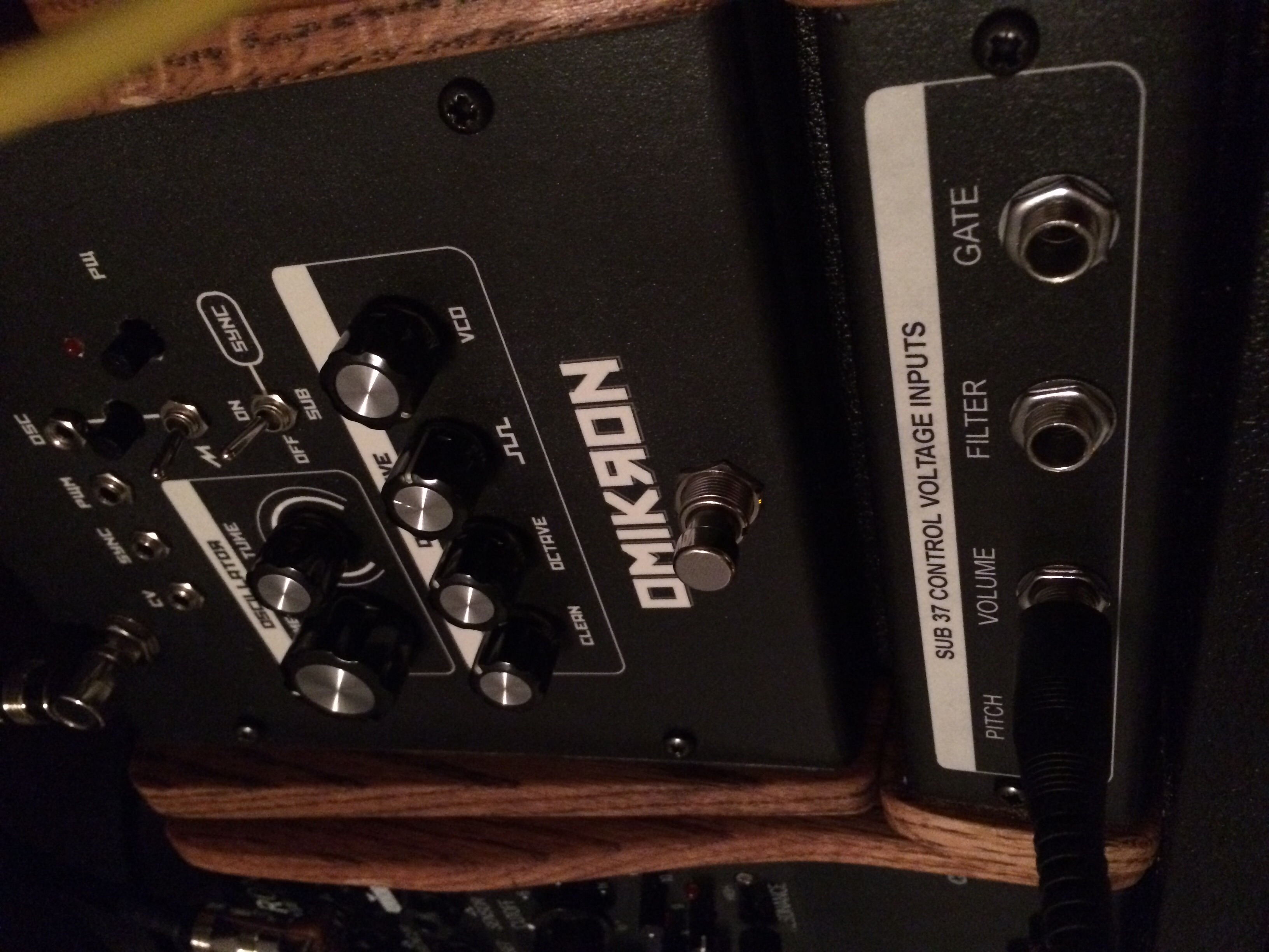

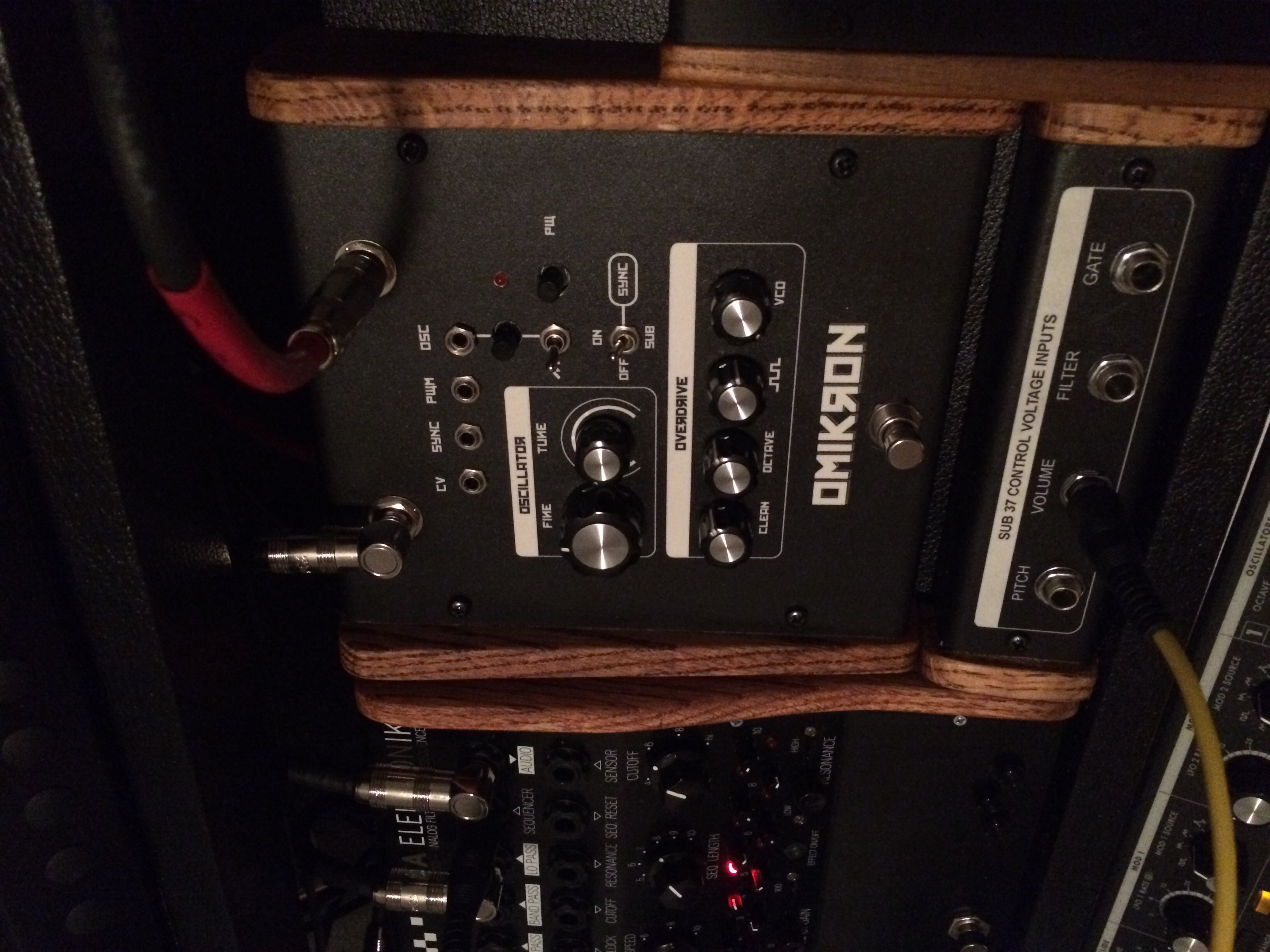

Every pedal I get turns into a moogerfooger. I already posted the custom side panels I made for my Koma Elektronic pedal, but that was just wood working. This time, I took a new Dreadbox Omikron (that was a factory b stock for faulty silk screening) and made a new enclosure for it. It was small enough that I could make a patch bay for my synth, and keep it to the MF foot print.
Both of these enclosures started out as flat 16ga steel and a blank of oak.

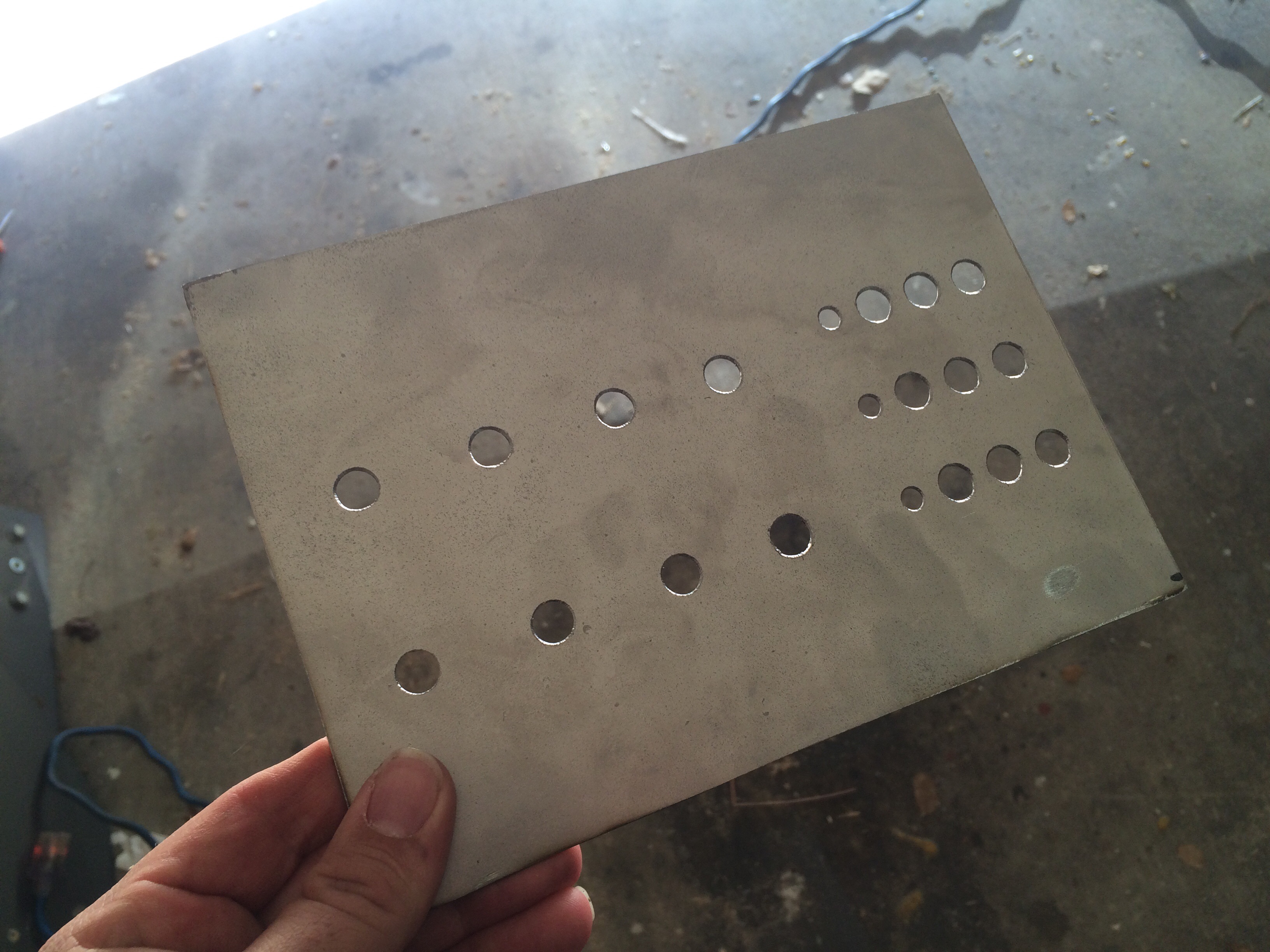

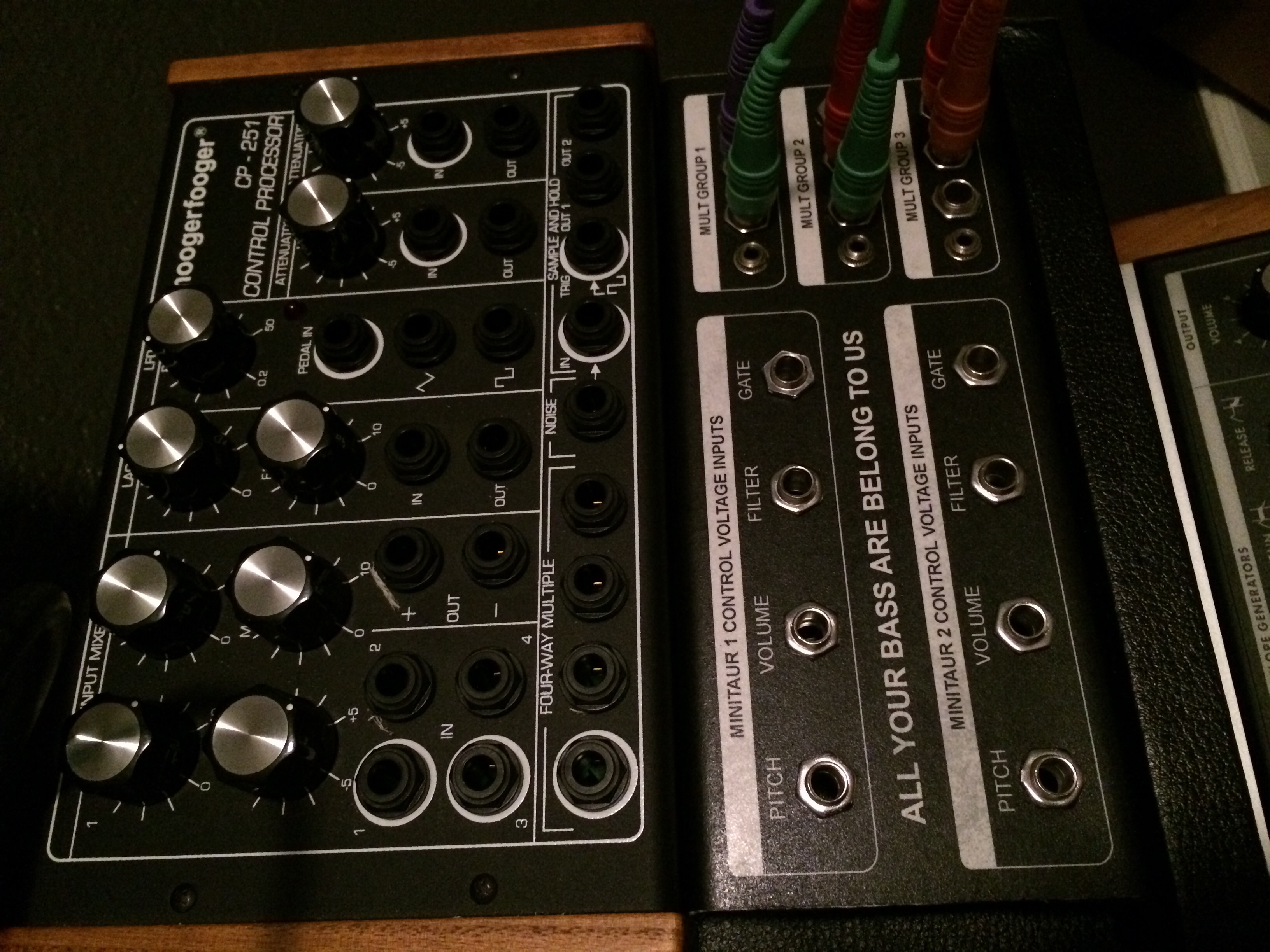

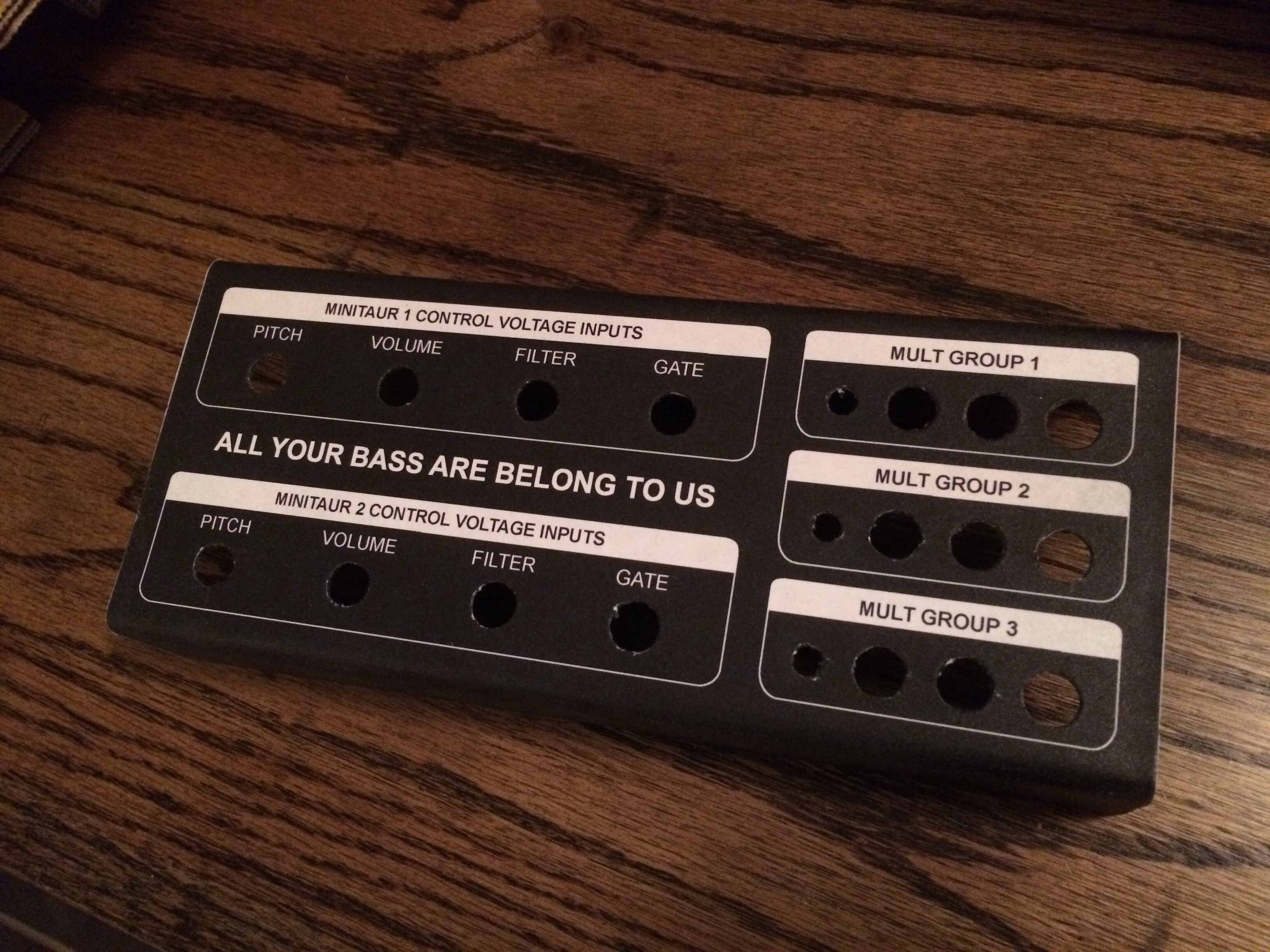

Today I decided to build this.
Started out as flat 16gauge steel, and a vector file I built over lunch. Then, bent it in my metal brake, and put the graphics on it. Now an evening of soldering... I'll make the wooden cheeks this weekend. This unit, when stacked on top of the Cp-251, is the exact same height as the moogerfoogers. The multiplier groups are to replace the section of mults that I gave up when I sold off the Korg MS-20m. Each group has 3x 1/4 and a single 1/8. So they can either get Cv from my beatstep pro and distribute it, or get voltage from any of the moog gear and covert the connection down to the smaller jacks on the dreadbox units.

Got it all wired up tonight. Holy crap soldering the mults is tedious. I'd show you the inside, but I would hate for it to come up on a google image search for "moog wiring". This thing looks like (what I imagine) the inside of a swarmatron looks like. But everything works perfectly. By my naked ear calculations, the voltage drops from using the multipliers is negligible. I even bridged several groups together and had one source going to 6 different things, and the drop was 5-10%. Pleased.
Now I just need to make the wood sides.
