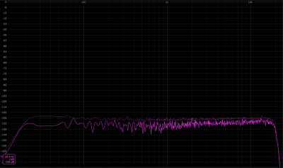

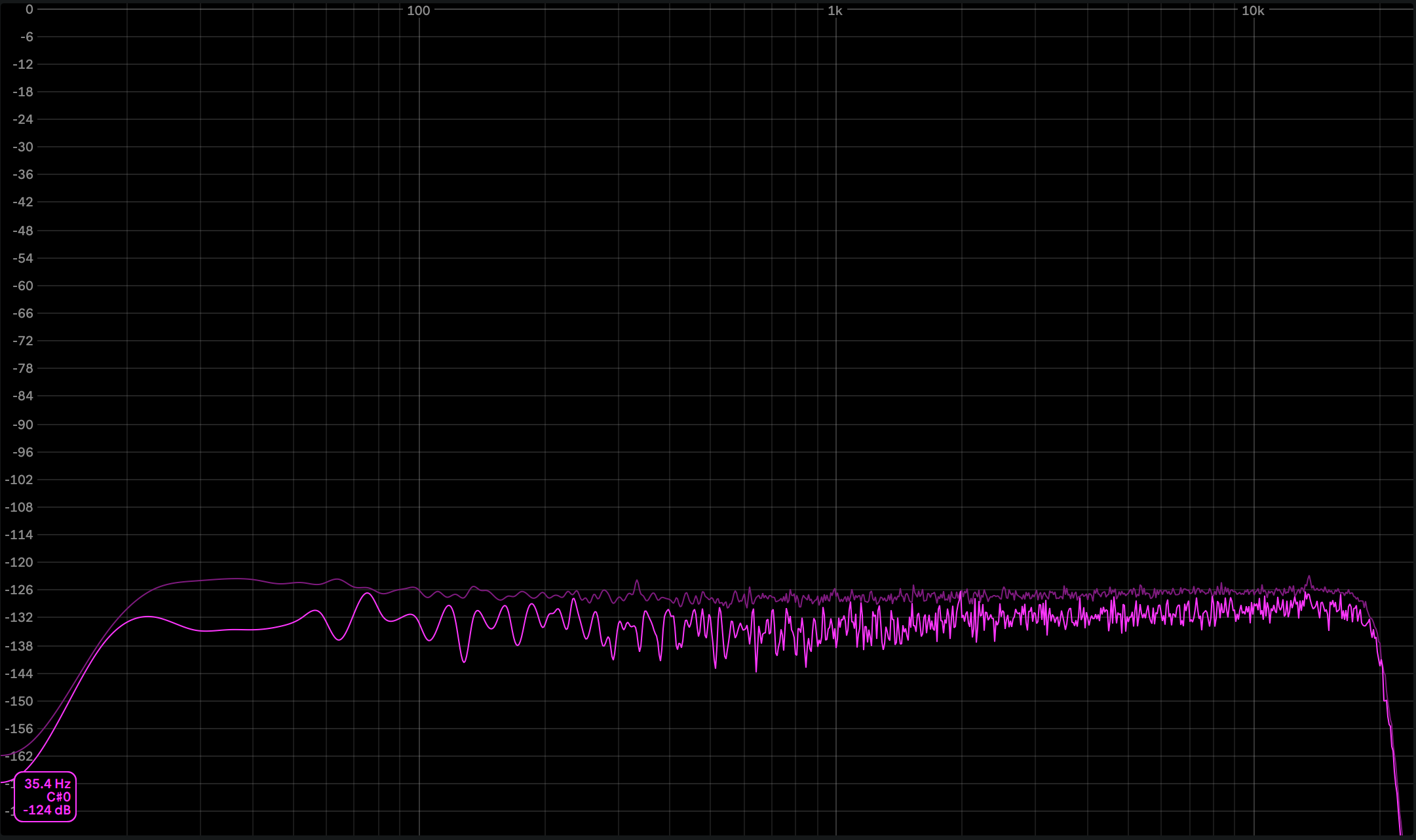

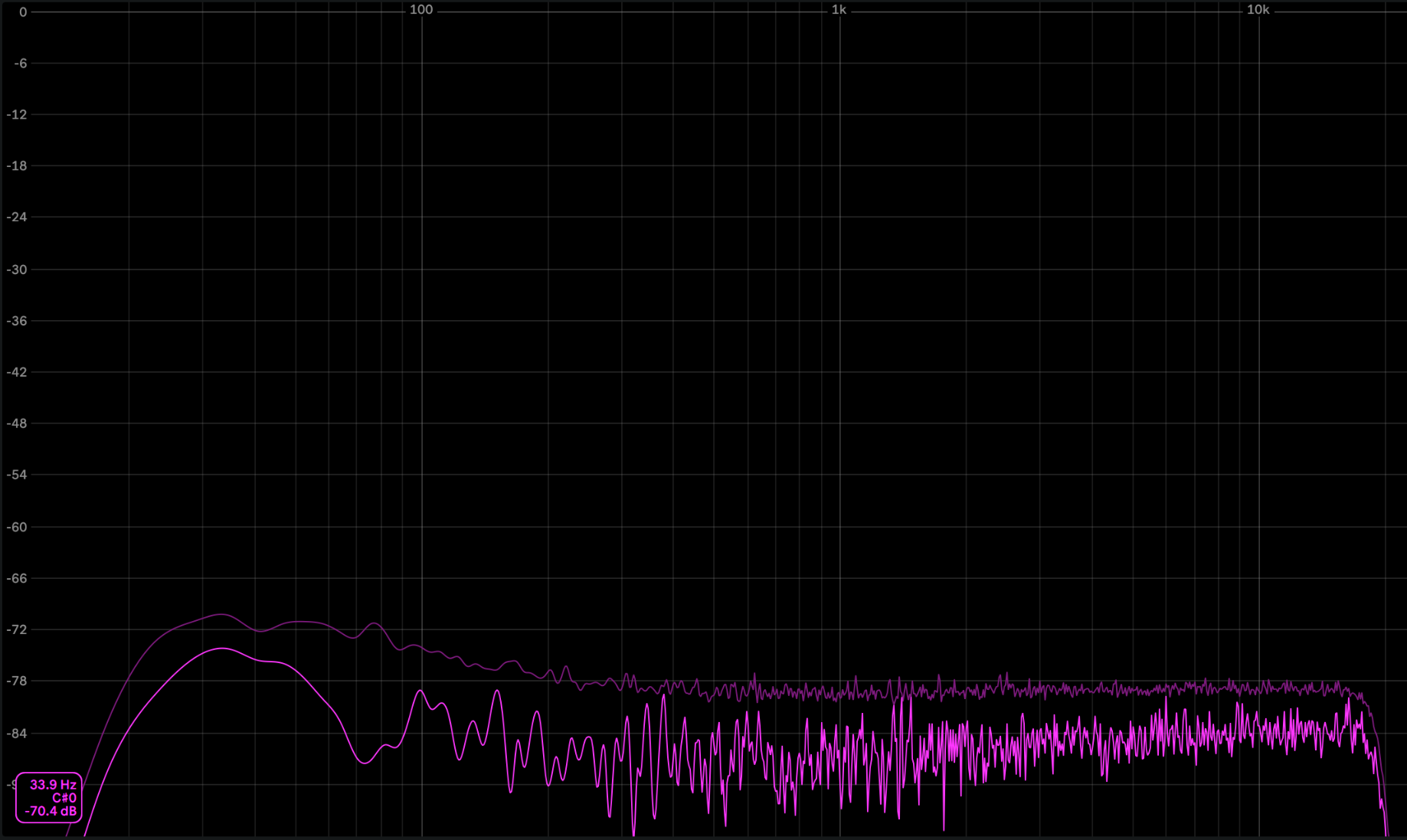

For comparison reasons i'm providing this info:
- Moog One 16 voice, patch level 1.4.0
- Ableton Live 10.1.15
- Steinberg UR22 mkII Audio Interface
- Klotz B4PP1-0300 (Neutrik jack) Balanced TRS audio cables
Oscillators disabled in the mixer, VCA at 100%, Master Volume at 100%
As you can see the peak is at -70.4db @33.9hz
For reference, normally the peak in the noise floor of the Steinberg UR22mkII is at -124db:
