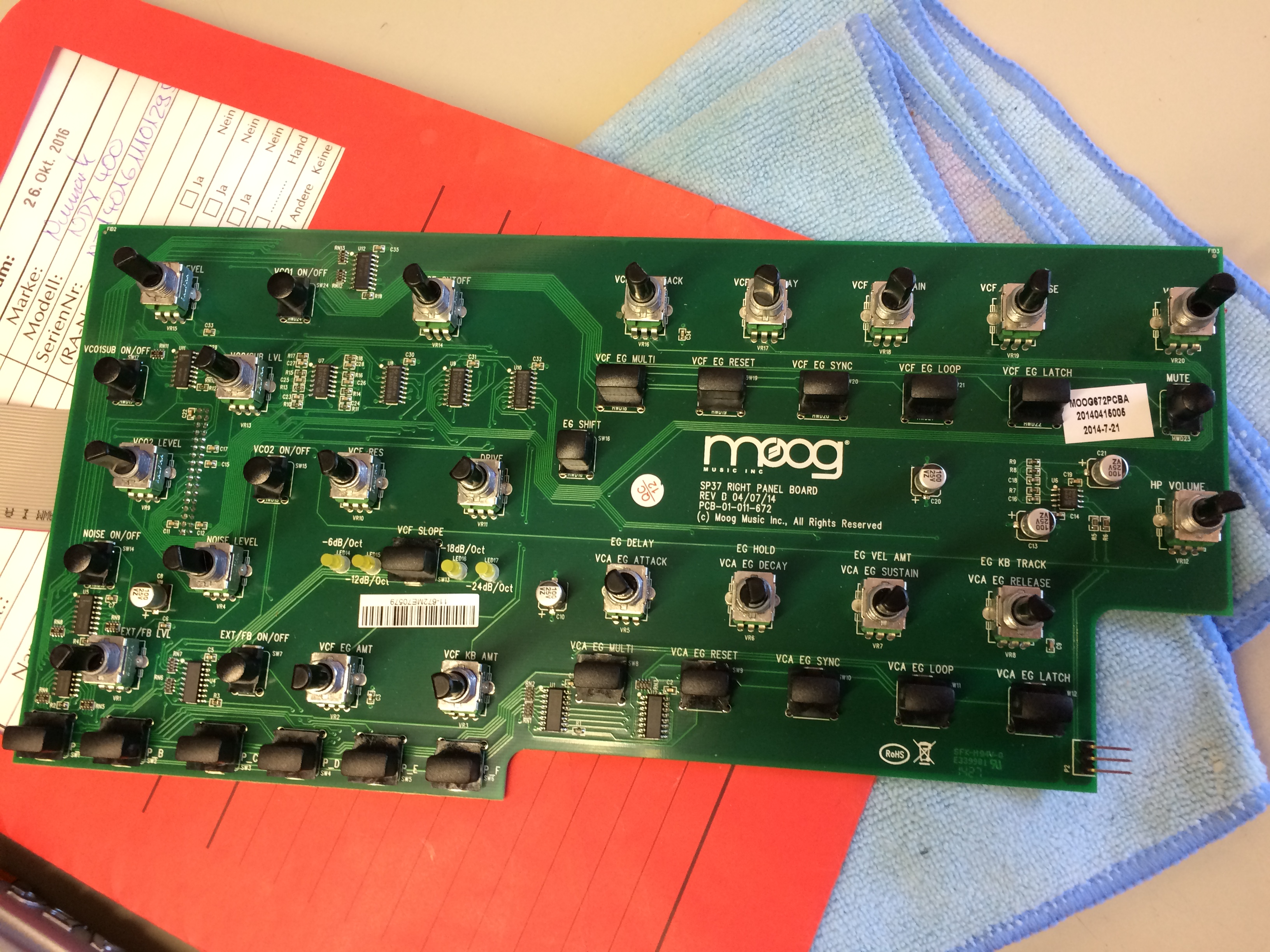

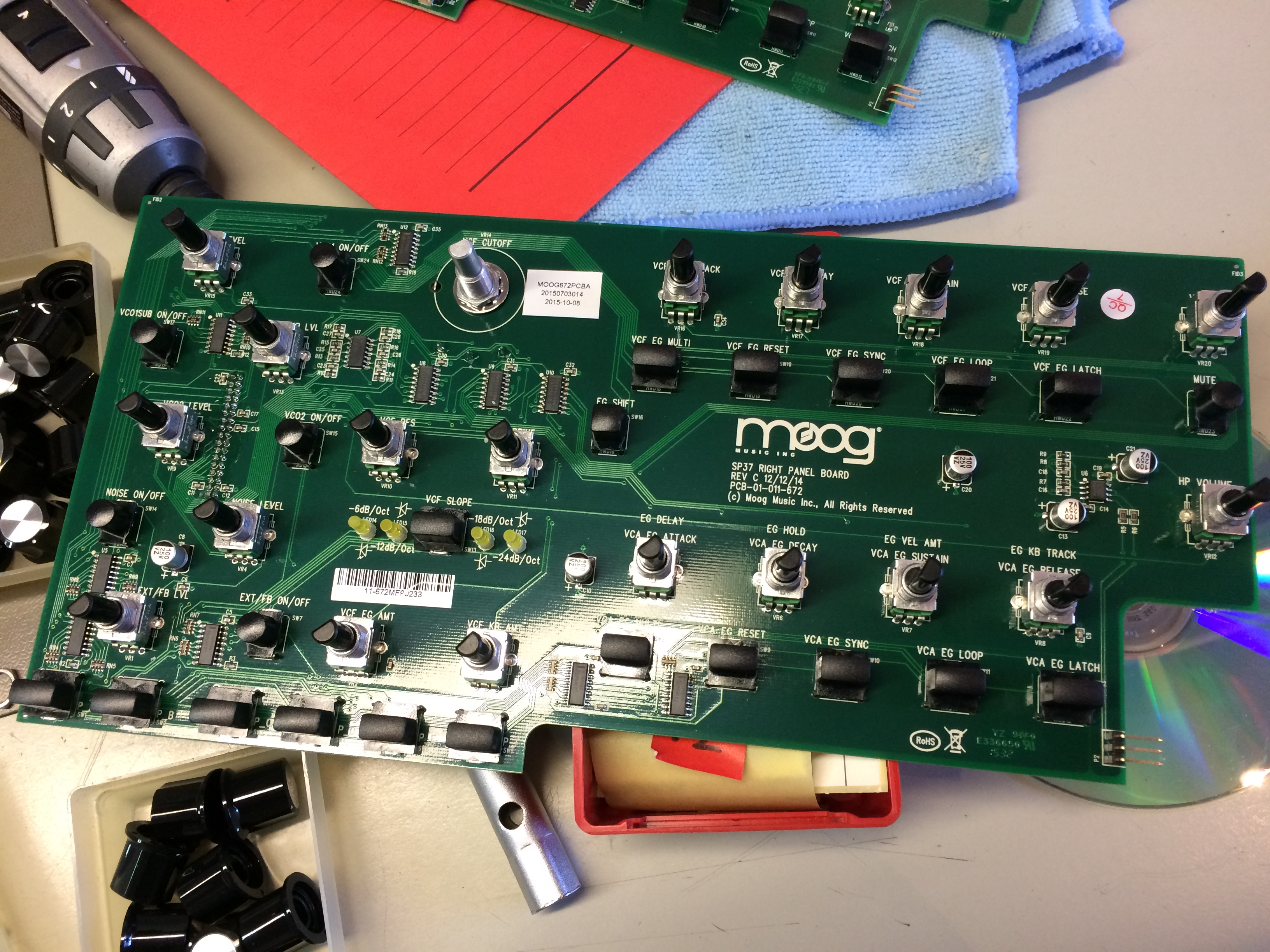

I don't think so. The main difference on the right panel board of the Sub37 is that the old filter cutoff pot is surface mounted vs the new pot is back mounted.Thus the whole construction is more solid. Simply replacing the plastic shaft pot with a metal shaft pot did obviously not solve the problem.
Original Sub 37 right panel board Revised Sub 37 right panel board

Re: Sub 37 cut off pot issue
^ Yes, the Sub 37s replacement pot is a metal type as we know. But there is no such pot in the Sub Phatty, at least not in the pictures I see of its PCBs.
The Voyager has all metal pots, so the Sub Phatty, like the Sub 37, doesn't have the same pots as the Voyager. That's part of reaching the price point. I make sure never to use any sideways force on the Sub 37 knobs... The revised Sub 37 filter pot ought to last "forever" though, being all metal as well as fixed to the front panel.[email protected] wrote:AFAIK the exact same pots were used on the Voyager and the Sub Phatty...
