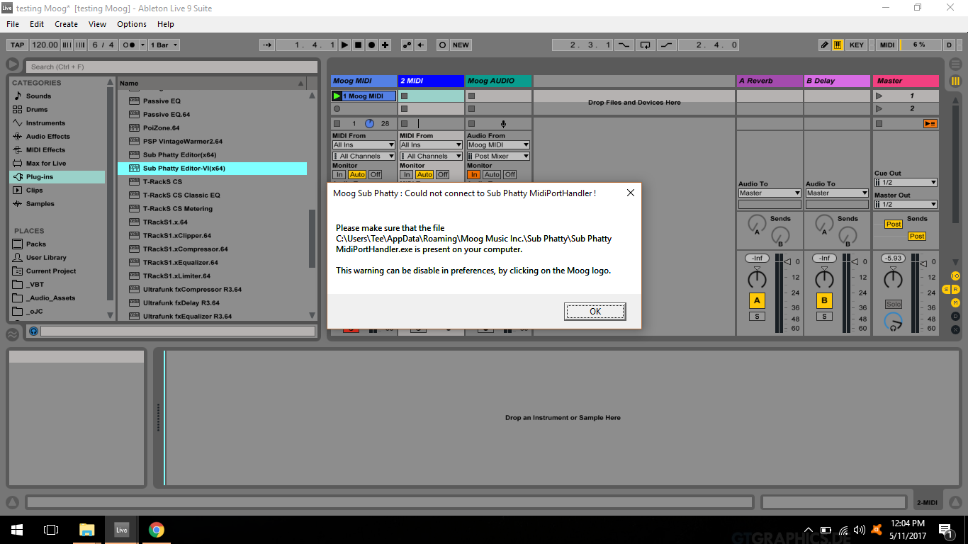

I just bought the Sub Phatty a little over a week ago and have been struggling with the VST editor within Ableton. I updated the firmware to 2.0.6. What's interesting about that is 2.0.6 isn't listed on their main download page--2.0.3 is the firmware update they have on that page. I found 2.0.6 on this thread. Why isn't it on the main download page? I also updated the VST's to be 1.1.1, which allowed both the Sub Phatty Editor(x64).dll and the Sub Phatty Editor-VI(x64).dll to be seen in Ableton. But alas, neither connect to the hardware when I drag and drop to a MIDI track. I get the "Could not connect to Sub Phatty MidiPortHandler !" message.
I'm using Ableton 9.5 in Windows 7 64bit. My audio interface is the Focusrite Scarlett 2i4.
What's the current situation on the editor VST? Am I just not going to be able to use it or am I doing something wrong? I welcome any detailed guide on how to get this properly connected. Thanks!

I had the same Problem in Cubase.
You have to turn off the MIDI control from Windows. I dont know if its the same problem, but in Windows 7 you had to turn off the MIDI Control for the SubPhatty in the audio preferences.
That your DAW is the Master. Then i used MIDI & USB. MIDI to control notes etc. and the USB to control the VST.
Its Pain in the ass.
