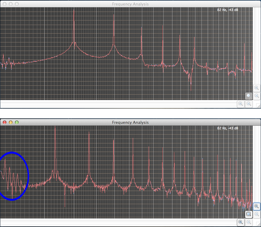

I am seeing some low frequency artefacts on the Sub 37 sample. that don't appear as large on the Sub Phatty. I don't know if this is the issue you are hearing.
I am using a program called Wavepad, selecting a 1 second sample of a note and looking at the FFT output. On the Sub 37 I can see a spike around 82Hz and harmonics, regardless of note, that I do not see nearly as large on the Sub Phatty.
I will try and upload some graphics but if you could record a few seconds of a single note on both synths then upload I can be more precise.

Further to my previous post, which has yet to be moderated and appear… I have now had the opportunity to compare the two wav files on headphone and I can hear a low hum (rather than buzz) on the Sub37 sample.
R.

Interesting….. E2 is 82.4Hz and my earlier FFT shows a spike at roughly 82Hz
