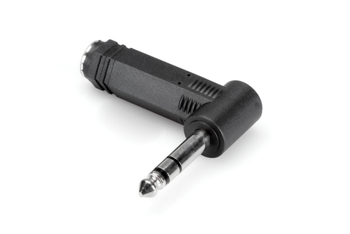

hmm I guess no one makes anything like that...I was thinking something like this right angle TRS, with a "through" female connection if you plug straight in
https://www.fullcompass.com/prod/038167 ... io-adapter
image link:
*edit* I can't seem to find a stackable TRS connector, similar to the Buchla stackable jacks, either. Oh well, easy enough to just use cables
image link:
