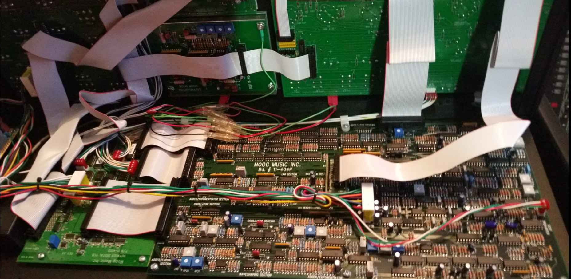

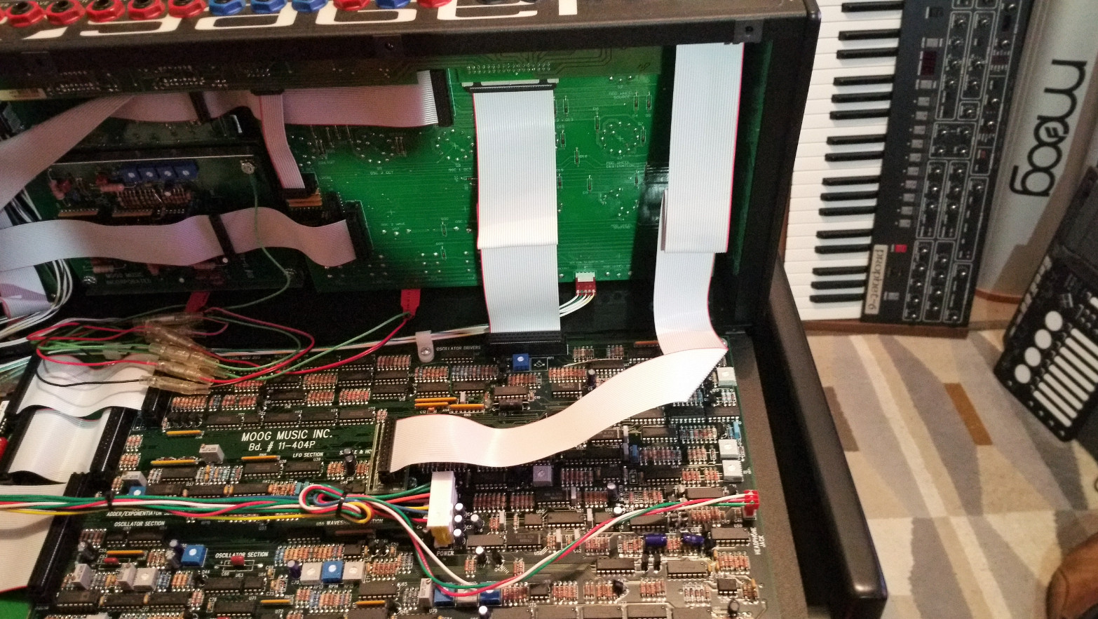

Found where problem is coming from on this board, will pull out later in the week and test all resistors, i am sure the problem is in number one photo section of the board.

I'm curious how you determined this to be the problem area and what the source of the problem turns out to be - especially without schematics.

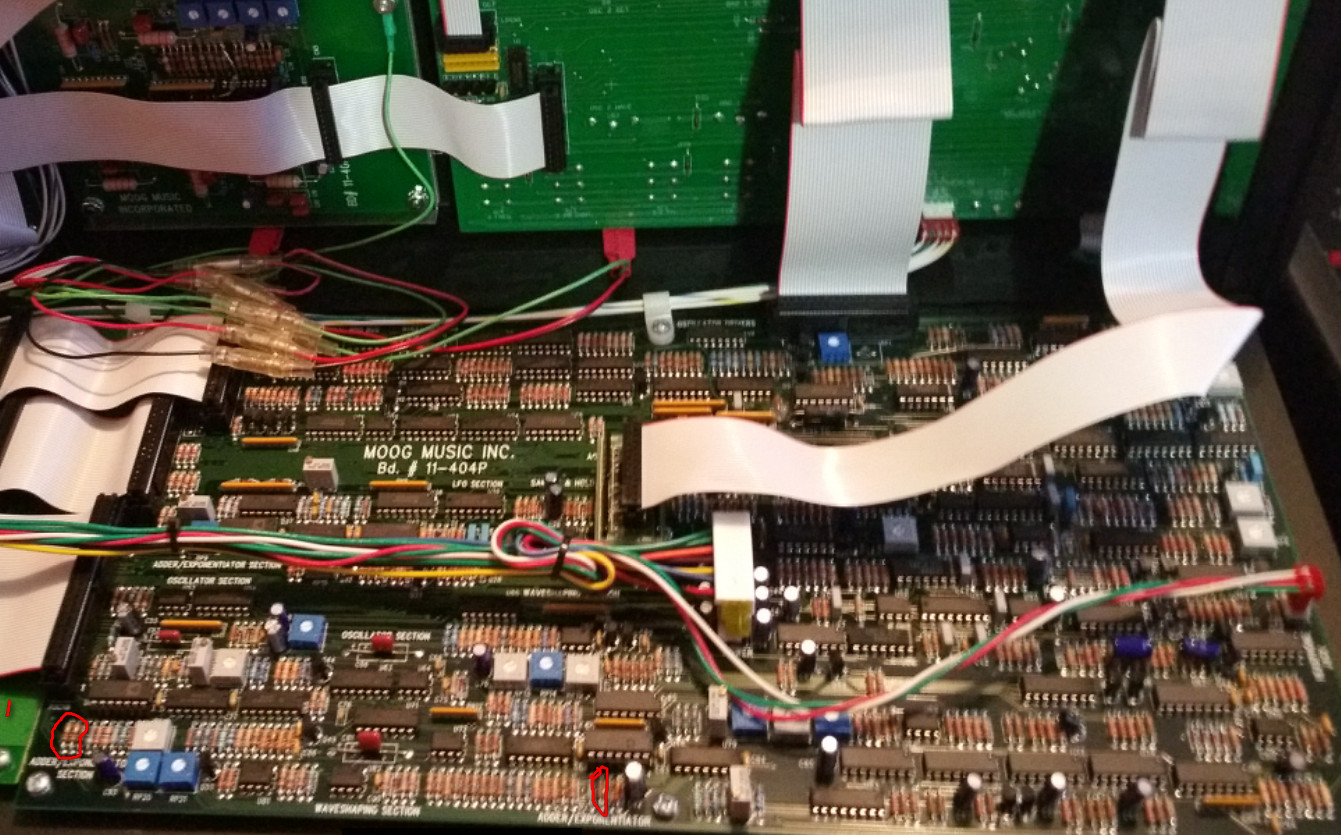

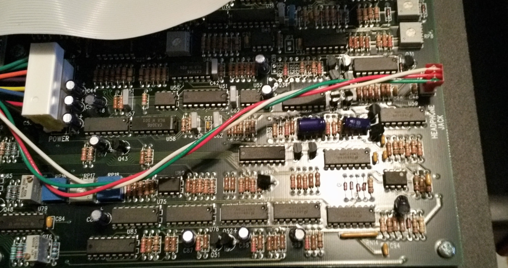

You dont need schematics to check a board, this is where the burning smell is i pull out the board de soldering one of the resistors and then testing them all. It is one of the resistors that have gone in fact i have done a bit of testing all ready and can tell you 3 are no good. The ones in red in the photo.

Visual inspection and burned smell - all good first order troubleshooting techniques. While those resistors need to be replaced chances are something else caused an excess current load, perhaps a part shorting internally downstream of those resistors . I'm not trying to discourage you, much the opposite and good on you for taking a stab at this. If it were me I would contact Moog and try to talk to a tech. They might be able to point you towards a potentially bad part that could take out those 3 resistors.

The symptoms that you mention (blank LCD) would indicate that the digital board is malfunctioning or that something on the analog board is so bad that power is sinking and thus the digital board has crashed but I'm guessing that the voltage required is quite different.
The diff between the Voyager and an Voyager Old School aside from the way that the pots are wired, is simply the presence or absence of the digital board which appears to the left of the analog board that you have there in your pictures.
Assuming the 3 resisters that you cited are NOT the problem, I would start by testing the output of the power supply and securing all ribbon cables and power cables. I'd also ready out to Moog and ask them if there was a way to test the digital board by itself (with no analog board connected). There must be a test mode.
