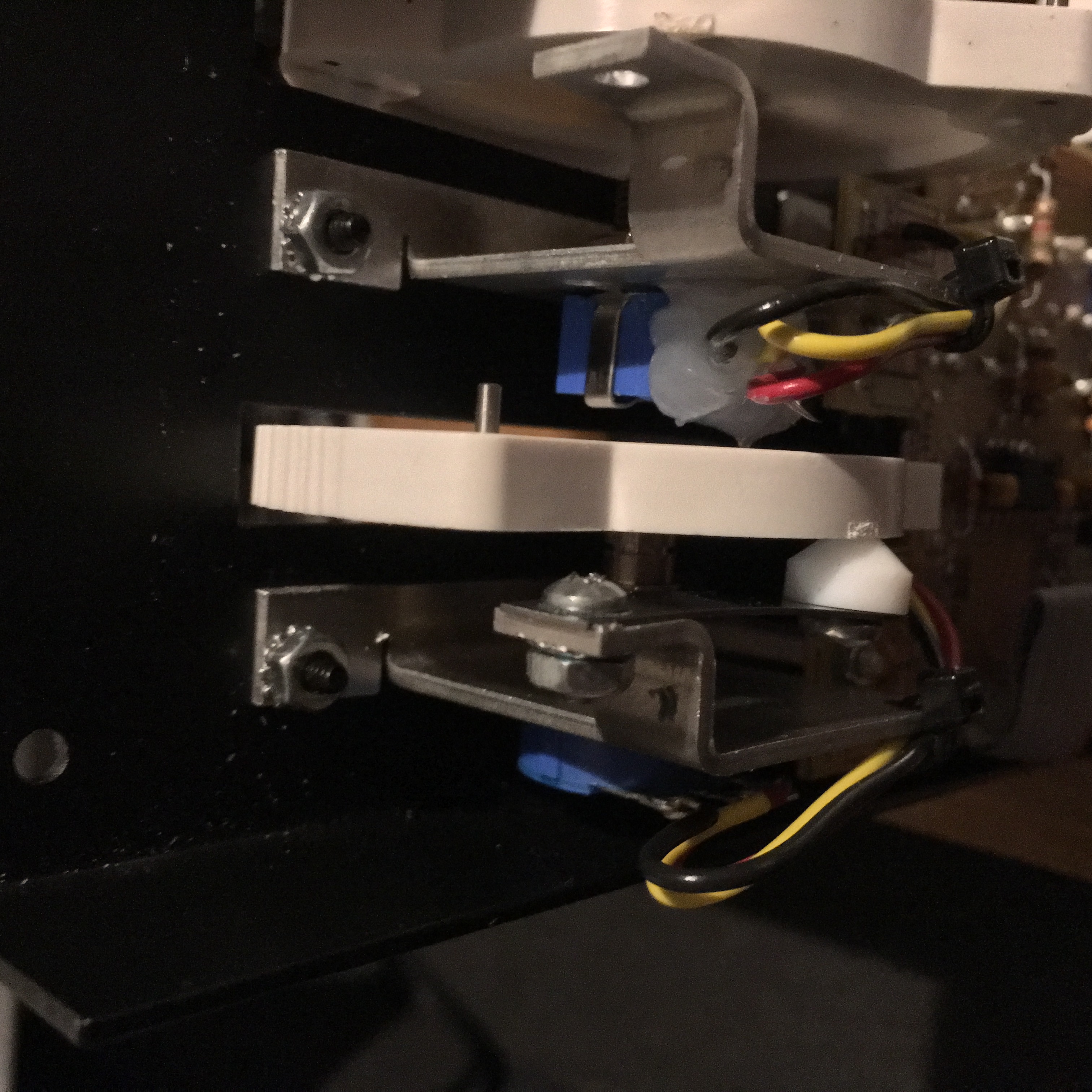

I just installed the MUSE on my reissue. Works fine. But you need to some technicsl experience. But no soldering needed.
And while I had the left section open, I get rid of the nut between the wheel holder and the tongue with the cone used to hold the pitchbend very tidt into the center possition. Now it isn‘t that stiff anymore. And still no random MIDI values sent in zero position.

thx for posting that, Till!!
it's a good idea, I may do the same
