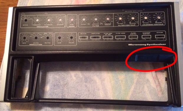

Im rebuilding a newly acquired Micromoog- cleaning the insides, lubing all the sliders/pots & staining the side panels. The only thing missing is the front nameplate, any ideas on getting a replacement?
Thx,
T
