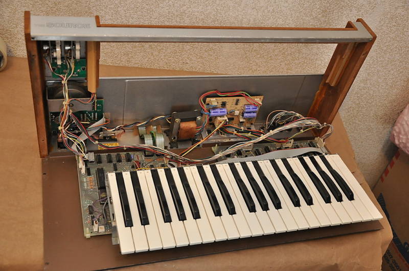

Your Moog The Source might be suffering from the well known bad contacts from the voltage regulators issue.
You don't really need to know much about electronics to fix it. All you need is a screwdriver and a pencil eraser. That's right, a pencil eraser.
Open up the synth, and locate the voltage regulators near the back. They will be held in place by screws on a metal plate that acts as a heatsink.
The legs of these regulators are inserted into sockets, and with time these metal legs will get oxidized or dirty and not make a proper electrical contact in that socket and cause all kinds of weird behavior.
Remove one, and rub a pencil eraser on both sides of the metal legs to remove oxidation, dirt and moisture. Do all of them, one by one.
To help you out, here's what the insides of a Moog The Source looks like. The regulators are on a back plate, to the right of the transformer in the middle.

Thanks a lot Alien. I will try that soon. Tomorrow maybe.
Do they look like this?...
http://www.ladyada.net/images/parts/7805.jpg
And how many of them are there in The Source?

You cannot replace the battery with a Duracell or other consumer battery. They are not electrically compatible despite appearances or voltages. The BRC battery used in the Source is still easily available and it is highly recommended that the replacement battery be mounted in a "C" size battery holder, as I did with my Source:
There are three regulators in the power supply.
