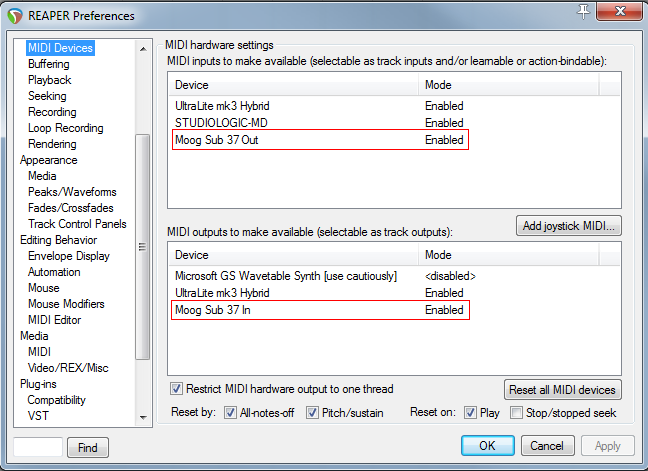

Since i installed driver v3.30.0, i must use “IN” as output and “OUT” as input MIDI ports.
Seems that the names for the MIDI ports have the wrong names.
Same in the Sub 37 editor and in Reaper audio.
We have discussed the question whether Out" should appear on the “Out” menus and “In” for “In” - or the other way around. This is tricky because if you are looking from the Synth point of view, then “Moog Sub 37 Out” should appear on DAW’s Midi In menus, because Midi Out usually connects to Midi In (and vice versa). This is how it was set on previous and current driver versions.
We also know that many other controllers and applications show as In for In and Out for Out, which would also be correct if you are looking from the computer’s point of view (rather than the device’s). We do consider to change that back to In for In and Out for Out, and it’s on the queue. Thanks for point this out though !
