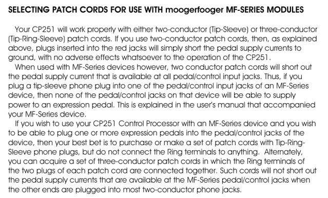

This is from the CP-251 manual:
Hope this helps.
