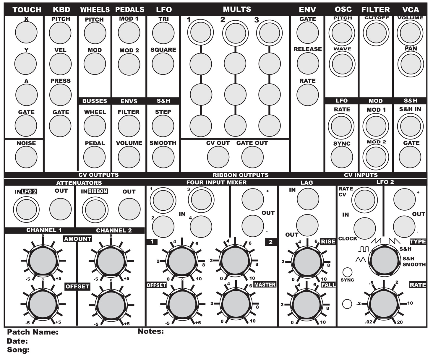

someone here had posted a patch template for the XL panel, if you search you can probably find it
I plan to print up a bunch of pages & use them in a binder as reference, just like the minimoog patchbook
also on the voyager, when I save my patches I try to include details of how I patched the XL patchbay, in very shorthand
Is it this one? From the KnobTweak archives:
Edit: A .pdf version of this sheet has also been uploaded to the MM Voyager Facebook page.
aha that looks like it!
I have an aversion to facebook, is the Knobtweaks archive available anywhere else? would be nice to get the PDF
