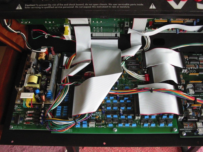

UPDATE; In speaking with Jared at Moog, it seems that the digital board is still an original Rev and was never upgraded by the previous owner. It will only take Bank A and 128 presets. Bummer yes and no. I have gone through my editor/librarian and flushed out all the presets that I don’t really like and I am good to go with the 100 of so remaining, Plus, the ease at which I can replace the bank makes it less of a ‘doh’ moment. I did not check that all the banks were there when buying.

It is a hardware update. You get a new digital board. And it was sold as field upgrade (to do it yourself) or you took your Voyager to a Moog technician.
I did it my self. No soldering needed. but you need to measure some voltages with a good voltmeter.
My original digital board was through hole soldered. the new 3.0 hardware upgrade board was SMD mainly.
I checked with Moog, and they no longer carry those boards. Not a big issue, as a I have an XL that gives me 8 banks.
