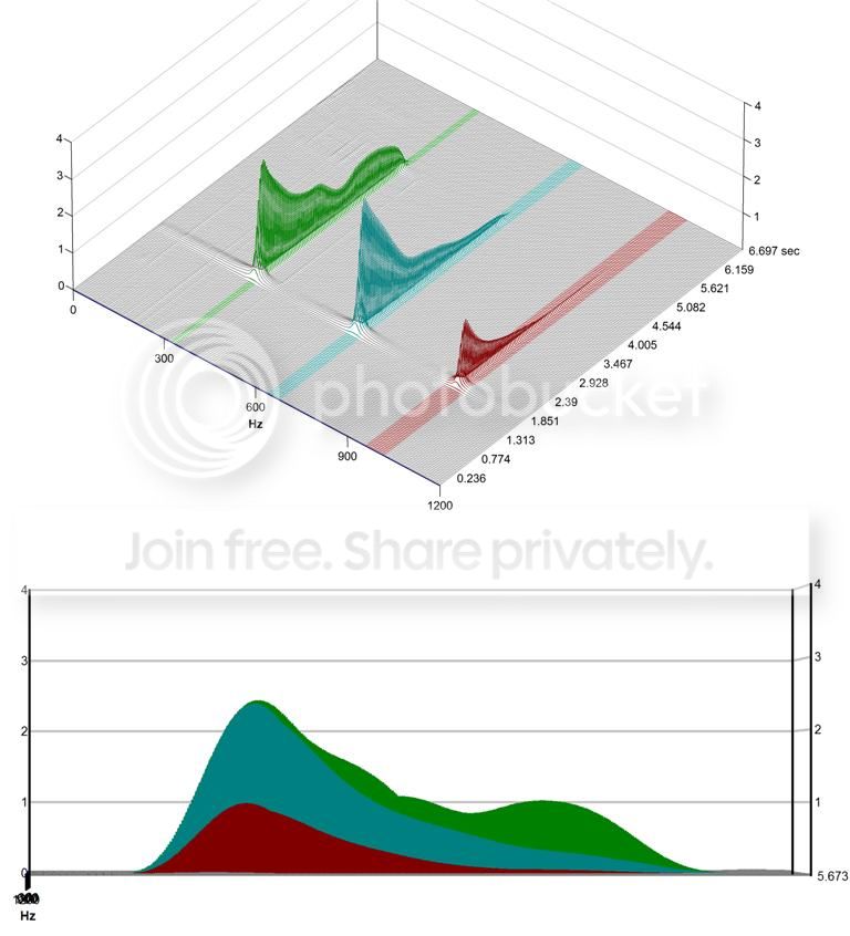

Before midi was born, there was a least one pitch follower that worked very well, the Korg MS-03 (in the 70’s). Why have things not improved over the last 40 years. Again… very technical, but my own findings are this: pitch tracking work better on string instruments with flat or dull strings, which yield a more rounded waveform. On bright strings, the content of harmonics and subharmonics messes pitch tracking. The second harmonic on a bright string is often of higher magnitude than the main pitch itself.
This image shows an high E string of a guitar (329 Hz), its second and third harmonic and envelope shapes.
