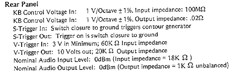

I have Moog Rogue and im trying to trigger it from drum trigger Roland RT30K mounted to my kick drum. Unfortunately it dosen’t work but when i put signal from drum trigger to mixer where i put some gain and i go from mixer to Moog Trigger socket it works! So is it possible to do it without mixer? In attachments You have specifications and rear panel photo of Moog. Maybe i need special cable for that? Now im using stereo cable from Roland drum trigger.

What you have there with the RT30K is simply some sort of Piezo trigger.
What you need is a trigger convertor - I’ve built them many times in one form or another.
I used variations on the audio to trigger circuit that appears in the Modular Moog service manual for the 961 interface.
You’ll need to experiment a bit with it though, that cct is for an actual audio signal which will be a lot stronger than what you’re getting out of your Roland.
Tom
