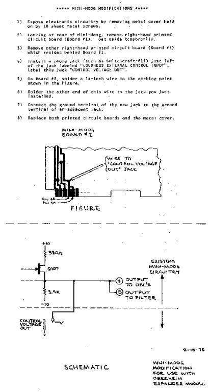

This is from an original SEM manual apparently..

Being able to control a SEM or two from the Mini’s keyboard, having a little outboard Mixer to blend them, or running it into the ex. input would no doubt open the sonic landscape. I don’t want to drill holes either so if I was going to mod mine I’d run any jacks/switches etc. out from the left hand controller inside the case, like how KL designed OptoKey’s MIDI jacks.. A couple of solder points on a pcb here and there if done correctly aren’t going to hurt anything. Added functionality is always nice to have for when you want it!

Fascinating that Oberheim used to produce the instructions to hack up your Minimoog and it’s also very interesting that you use the same trigger input as an output along with the ‘special’ cable that came with the original SEM. CZ Rider writes about this in the link to muffs that is posted above.
Here’s the full manual: https://archive.org/stream/synthmanual-oberheim-sem-owners-manual/oberheimsemownersmanual#page/n0/mode/2up

The CV out was not a hack to the Minimoog, but was a last revision factory improvement. The last Minimoogs had the CV out and had the S-trigger socket properly labled as “S-trig in/out”.

That stock revision looks interesting because there is a scale pot indicating there is a special circuit and not just the simple Oberheim mod with only the keyboard CV out. Perhaps it includes the pitch bend and possibly the osc. modulation?
That is how I would do that mod, with a summing amp adding in the keyboard CV, pitch wheel and osc. modulation. Jan Hammer must have had a similar mod to his Mini to control his Mini/SEM combo as pitch bend was such a large part of his playing style.
Naturally this all happened before MIDI. Today it would be so much simpler to use a MIDI keyboard controller to link both an SEM and Minimoog via a proper MIDI to CV converter. If I absolutely had to use the Minimoog as the controller, I would go with the digital scanned Opto-Key mod without the MIDI. And sum the very stable CV out from the Opto-key with the pitch bend and mod ammount. Simple mod really, with a small circuit to add those voltages, the Opto-Key a little more challenging though.
