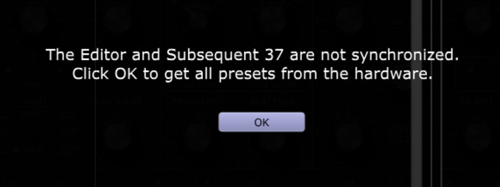

The editor and subsequent are not synchronized. Click ok to get all presets from the hardware
every time i re-open the Plugin i getting this ad:
The editor and subsequent are not synchronized. Click ok to get all presets from the Hardware.
I click ok, have to wait.. use the plugin.. close the plugin,.. after some work i re open the Plugin and again;
pretty annoying, what is the problem ?

the problem is still there…
I also had it (for the first time) today.
Hi, have you already found a solution to this issue?
I have the same problem and because of that the Subsequent 37 CV Editor is pretty much unusable in Cubase. I have Subsequent 37 CV. Operating System: Windows 7 Professional - 64-bit
The Editor always asks again to retrieve the presets from Subsequent when I change the track in Cubase and return to the Editor track. And it takes quite a long time every time. This can’t be right? What settings need to be made to prevent this from happening again?
I would really like to use a lot of Subsequent 37 CV Editor! So would anyone know a solution to this problem?
Good Moog workers, can you help, please?
Same problem here - can’t seem to find a way around it :frowning:

Hi again,
Now I have uninstalled and reinstalled Moog MIDI driver (Moog_Sub_37_USB_DriverSetup_v2.23.0) and the Subsequent 37 CV Editor (Subsequent37CV_Editor_v1.1.0) three times. Every time after that operation, it has seemed that the problem would be resolved, but as soon as I started to do my own setup options in the EditorsEDITOR SETTINGS’ and ‘MIDI SETTINGSmenu, then the problem is back.
I’ve got the impression from these experiments that if I make even one wrong choice in the Editor, then it starts making that annoying request again: “The Editor and Subsequent 37 CVs are not synchronized. Click OK to get all presets from the hardware.” And that there is nothing I can do after that except to uninstall and reinstall the Editor and the Moog MIDI Driver to get rid off the issue. It seems that the Editor is saving permanently information about these conflicting settings to computer and there is nothing you can do about it (except to uninstall & reinstall).
