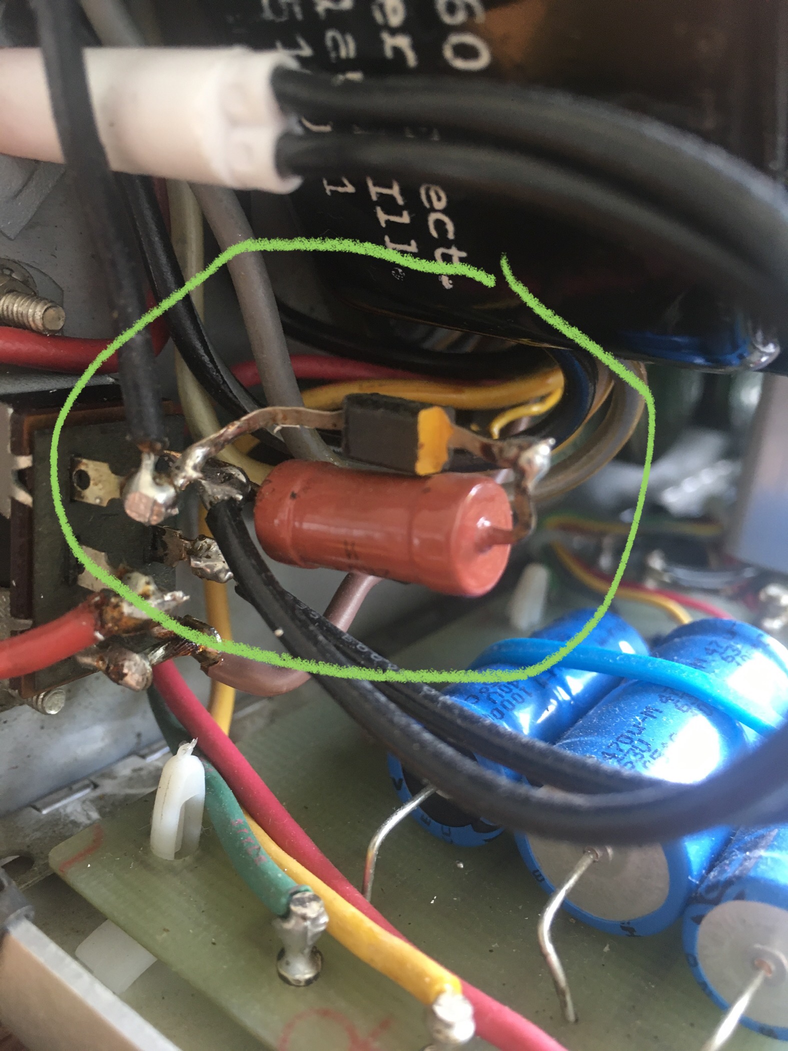

And another question: how do people in the eu wire up their power light?
Its 125v and obviously we are running 230v. On my unit there is a 2k resistor and another part that i can not even identify in series (can you?). Is this legit? Does not look like this was done at the factory and the hot lines are not even isolated.
