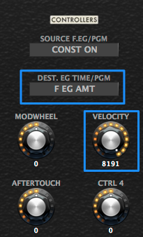

On Mod1 controller set the modwheel to 0 and the velocity to 100%, then set Mod1 Destination to PG TIME and select in Controllers>Edit>Destination = “F EG AMNT”
I have sended a image capture.
