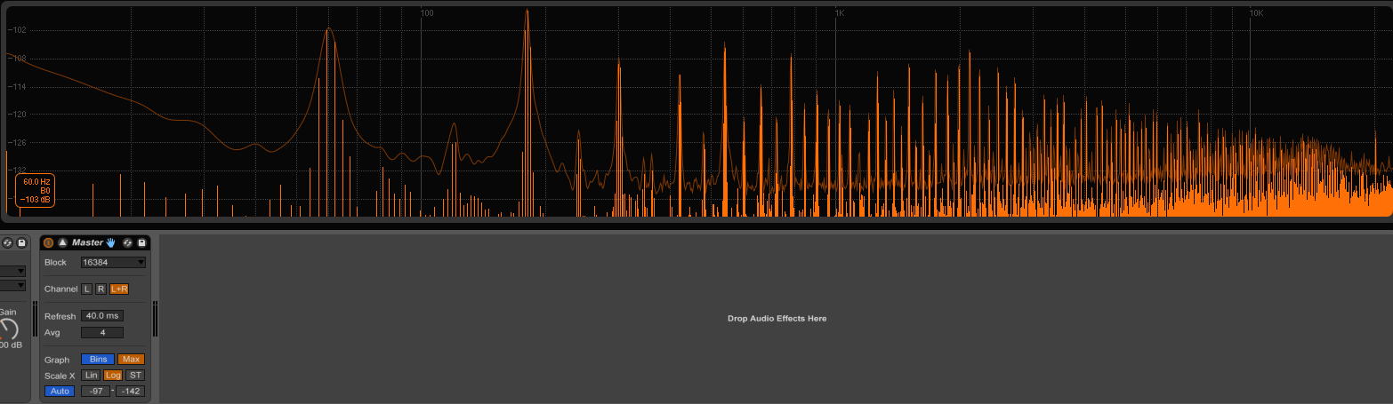

Has anyone else had electric noise issues with the Audio Out on their Sub37? A few days ago I noticed a 60hz (and higher) hum coming from my Sub37. It is not a ground loop issue as all my other equipment is plugged into the same outlet with no issues. I’ve tried plugging directly into my Apollo interface as well as leaving it plugged in through my mic pre. Any ideas?
