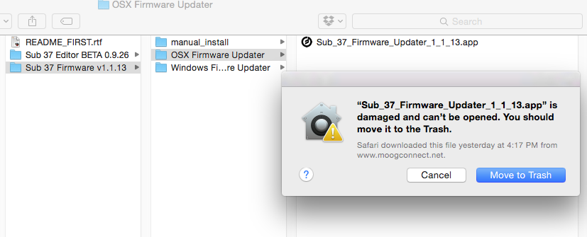

Sub 37 Firmware Updater 1.1.13.app doesn’t start on Mac OS X with gatekeeper enabled. (known issue):
Updater doesn’t start on Mac OS X with Gatekepper enabled, user gets warning message “app is damaged and can’t be opened. You should move it to the Trash”
Known method by overriding Gatekeeper settings by Control-click/right click the icon of the app and opening it from contextual menu DOESN’T WORK.
To run the app, temporarily disable gatekeeper in OS X Security settings.
The updater itself has no issues and updated my Sub37 without any problem.
Tested on MacPro 5,1 / Yosemite 10.10.5
Reply from Amos:
“Yes it’s a problem with the code signing, which we still need to fix.
The current installer will run if you set your security settings to “run apps from anywhere” but we will make the necessary changes here so that the next version will run normally.”
