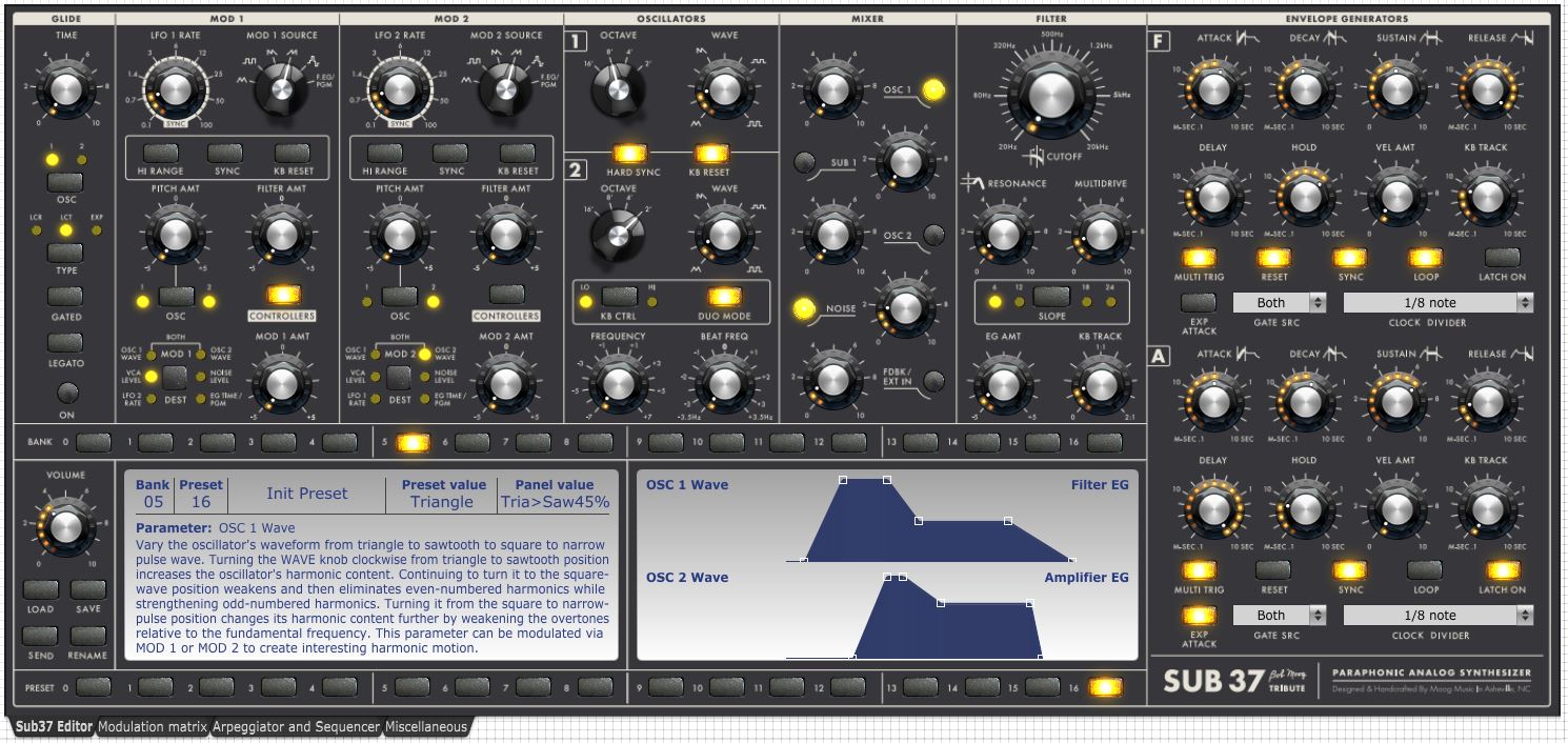

I decided thus to build an editor that would allow me visualizing that.
I found Ctrlr and I’m busy to build a panel for it.
I can already achieve nice things as:
  • panel layout with look and feel as the real synth
  • DAHDSR enveloppe graph display
  • selection of Filter or Amplifier EG graph display
  • direct access buttons for EG parameters using the Shift button on the synth
  • name and actual value of parameter is displayed in the “screen”
  • explanation of the parameter from the manual is also displayed
  • leds acting according to button’s selection
  • series of radio buttons for the bank selection
  • series of radio buttons for the preset selection
  • load and save .syx file buttons (no code yet)
