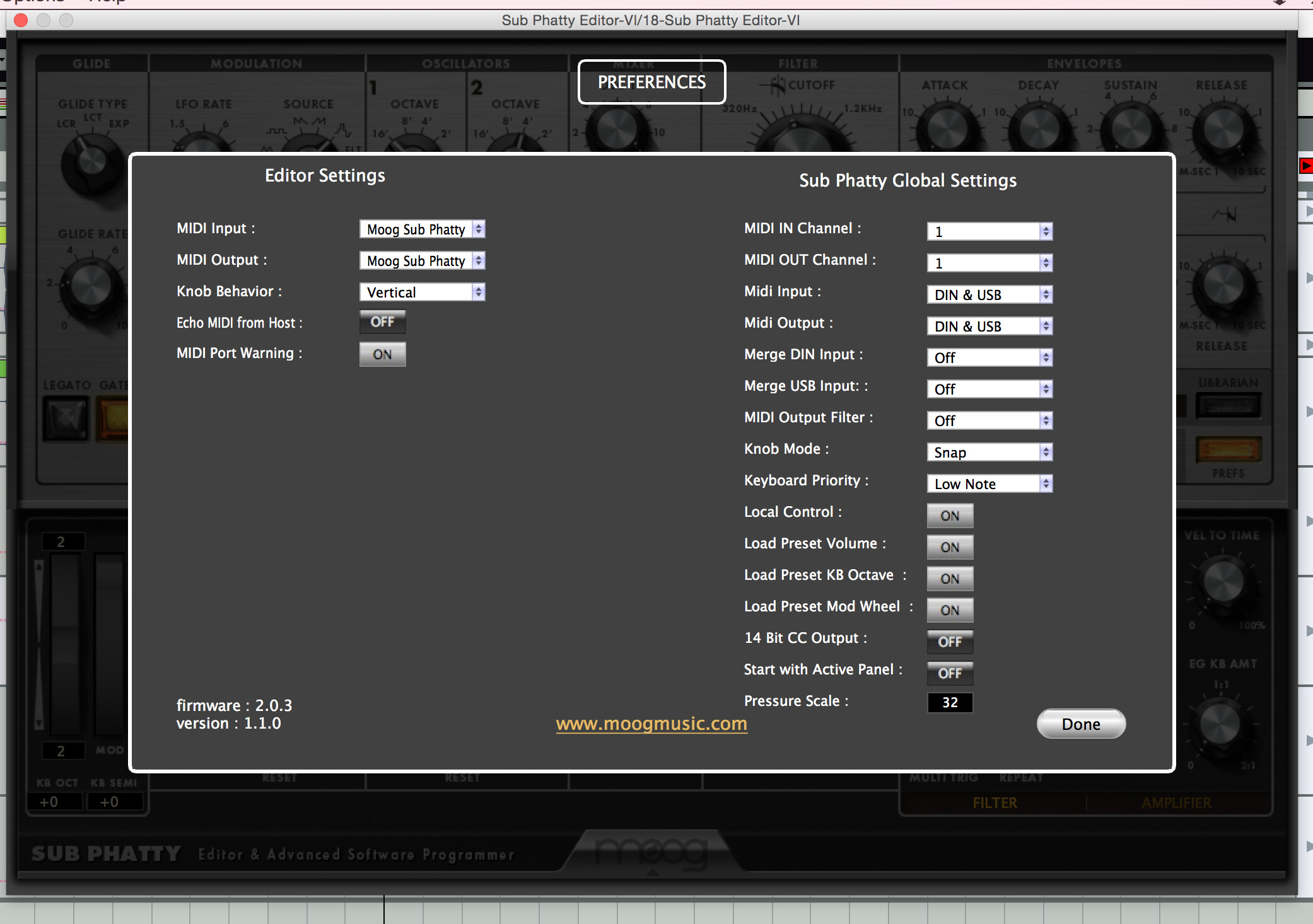

Hi all,
I’ve read, searched and tried all possibilities, I think, but I simply can’t get it to work.
When playing midi clip notes in Ableton, it doesn’t seem to send it to the Sub Phatty for playing, nothing happens.
I can record the midi notes from the Sub Phatty into Ableton, but not play them the other way around.
I’m using the Sub Phatty Editor VI
What am I doing wrong.

Works fine here. These are my settings:
MIDI Settings.
Also, turn on OUTPUT / SYNC if you want to send clock timing for arps & seqs.

Thanks, that works for me too, but only if I’m not using the VST editor… I would have to use the standalone editor for that to work… Would be nice to use the vst editor so you can save the patches with the set… Is there something I’m missing?
Hey! So I was able to get this working for me in Bitwig Studio by changing the “ECHO MIDI” setting of the VST to “ON”
Now I dont need to do any additional routing to get midi data from clips to go to the Sub 37. All i do is add the VST to the channel and bingo the midi data from the track is sent to the sub37.
Brilliant! Solved the problem for me. Thanks.
