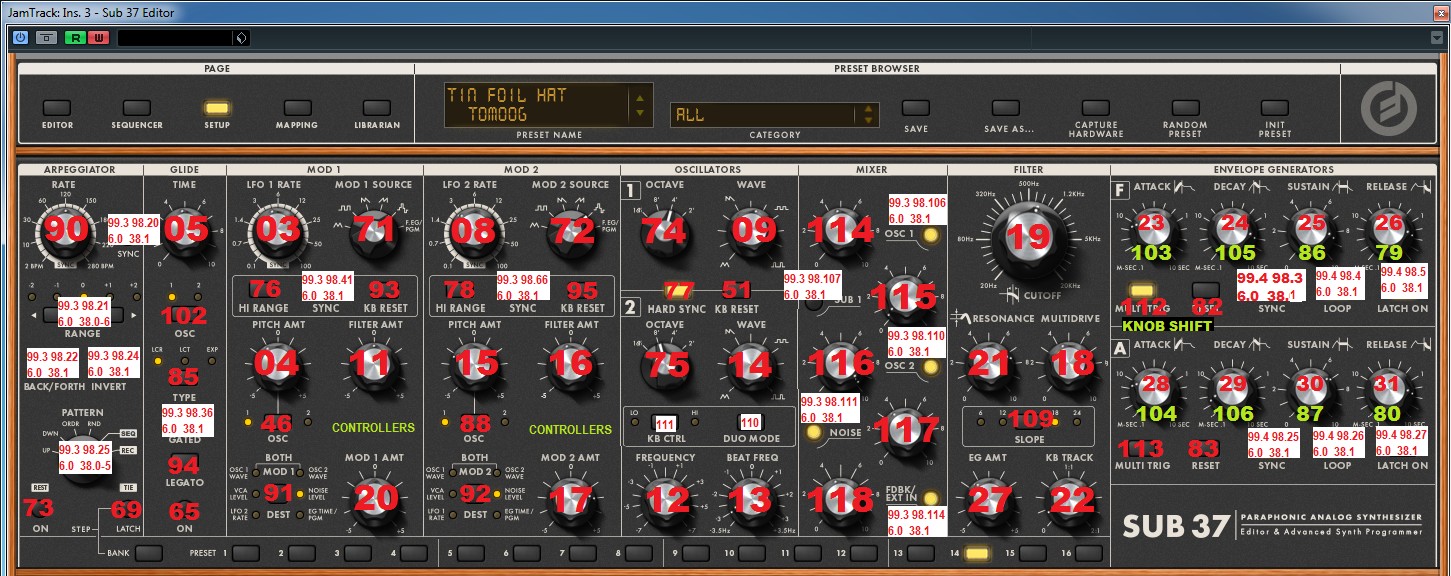

Instead of hunting thru the back of the Manual for MIDI CC numbers, or using a Sharpie, download this attachment.
It’s the Sub37 panel editor showing MIDI CC numbers for knobs and switches.
I’ve cross-checked the values with MIDI-OX but if there are any errors please advise.
NRPNs settings are shown as little numbers and the “ON” value (usually 1)
e.g., MOD1 SYNC is shown as 99.3 98.41 6.0 38.1
means
CC 99 value 3
CC 98 value 41
CC 06 value 0
CC 38 value 1 (ON)
Some switches/knobs have both a MIDI CC number and NRPN numbers e.g., ARPEGIATOR LATCH so only the MIDI CC is shown.
A couple of switches are not shown on the Sub37 panel editor - MOD1 & 2 CONTROLLERS, EG KNOB SHIFT MIDI CCs
These are shown here in green.
