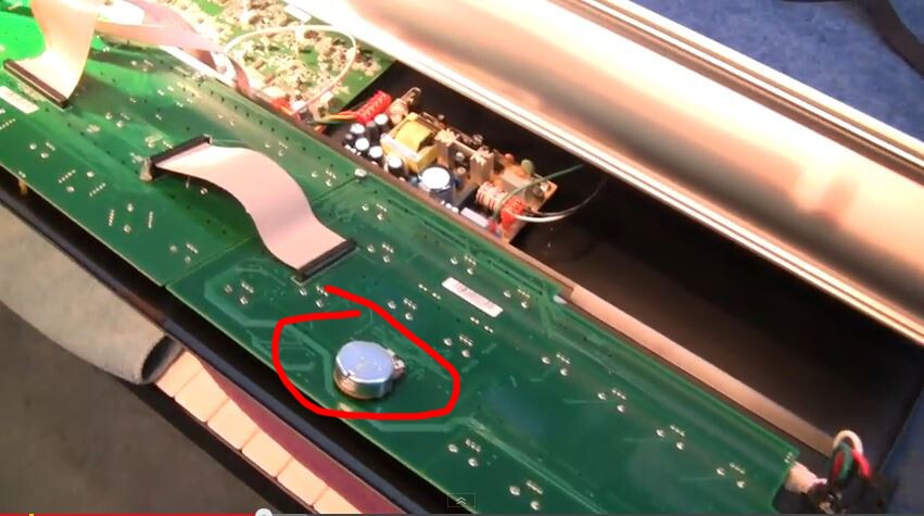

Right. This now looks like a genuine fault in manufacturing that Moog have addressed and kept relatively quiet until now. This video has exposed this faulty cutoff pot problem and upgrade by Moog well and truly now (see red circle).Looks like the cat is out of the bag. Thanks Markus!
Moog have obviously fixed this in the assembly line with a new top board and different pot. What serial number range are the “faulty” ones? my Sub37 is going to be worth considerably less in the future for resale when it becomes standard knowledge that buyers must avoid the “early ones like the plague” because they all carry this fault. We see this all the time with synths from the past where they have serial number ranges to avoid due to problems. I would not like to be victim to this please.

Do you see the little skull-like traces on the pictures? These are the traces of all the other smt pots. One does not simply replace a smt pot by a full size one without punching a hole through the pcb, or more fittingly, by redesigning the entire pcb board to acomodate for the new heavy pot. new board des not mean faulty one, only new big pot…
I wonder if one could drill the current board and not hit any of the circuitry near the filter pot.

So, the old filter pot was on the other side of the board, and the new one is a more traditional type, bigger and more robust?

correct. moog must have re-designed the board with traces going around a new hole to accommodate the new, more heavy duty pot. Moog has realized that the big knob of the filter pot puts extra sideways stresses on the little surface mount pots and they are not able to handle the extra pressures and they are failing. They must be proper chassis mounted traditional pots so they dont fail. And this is what we see here…Moog has changed the surface mount pot to be replaced by a traditional pot.
i doubt very much we can just drill holes in our boards and plunge in a traditional pot in its place. it would require a new board with a mounting hole and the new pot.

I agree. Modern circuit boards are often multi-layer, meaning that in addition to the traces you can see on the top and bottom, there may be traces embedded in the middle. If that’s the case with this board (and I do not know if it is), drilling through the board in the wrong place would be disasterous.

“Hi… My Sub37 serial number is 0581X ( “X” being my last omitted number) the manufacture date was 06/15. I did not know about this problem with the earlier Sub37s. I thought it was a bit strange having that great big Pot there but now I can see why they have revised it as it is the pot that would get most abuse over time. I hope you guys can get yours sorted out. Best wishes from Markus.”
so we have narrowed it down now. the change happened somewhere between 5400 and 5810 in only the last month or so. And we can confirm that Markus did not make the change himself, it was done in the factory.
