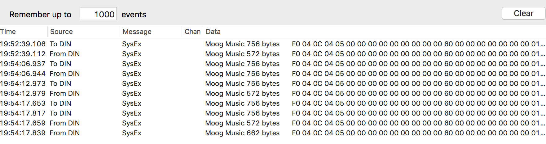

Then I went back to the DIN setup but connected DIN MIDI OUT on the ICA+ directly to the DIN MIDI IN on the ICA+ to see if I got the right stuff through the port. And suprise. The SYSEX messages are “destroyed” - sometimes they are full and ok (rarely) but often they are shorter. See attached image and I have attached an output and resulting input SYSEX.
This seems like the issue lies with the ICA+ MIDI and I have to debug that instead. Funny you do not have problems with the iConnectivity 4 you are using (the non-audio version)

in MIDI Monitor, I am still seeing more frequent success than in your example, but if I scroll a lot of presets quickly I start to see some failures too; truncated sysex like in your screenshot.
